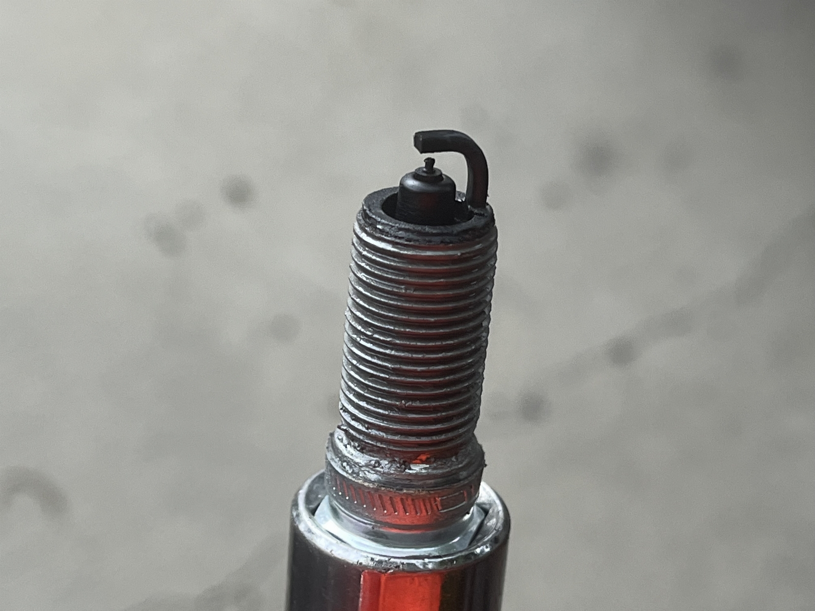

When i got my PPV last year, i changed the plugs and wires within the first couple weeks — And the plugs were rough when i pulled them originally, they looked bad and had gaps all over the place. Tbh i have no idea how it ran so smooth at the time. So i changed the plugs and wires with AC Delco.
Fast forward to now, truck ran smooth as butter until recently truck developed a misfire randomly on the highway. I felt reduced power and the engine was shaking as common when you’ve got misfires, but no code.
Limped it home and it took about 20 minutes of idling in the driveway before i finally got it to set a CEL - Cylinder 1 Misfire detected.
Pulled plug for cyl 1 and it was pretty rough looking, with thick carbon deposit coating the upper portion and the insulator.
Pulled plug for cyl 2 and it also had some carbon deposits
(Cyl 1 left, cyl 2 right)
I now have to assume all the plugs probably look like this to some degree. Looking for some guidance on how to proceed.
wondering if this could be related to DI buildup ?

Not DI buildup, that would be on the intake valve. Could be leaking injector, or bad lifter/cam lobe which is what I found on mine. Not necessarily with tick. Bad or no spark and the plug would be washed clean.

Thanks for the reply.
I’m aware that the DI buildup would be on the intake valves, but was wondering if it was excessive enough, could it be causing the fouling on the plugs
According to a TSB i found, this seems like it could be plausible.
If it was a leaking injector, wouldn’t only the one plug be fouled, because as seen in the photo’s, cyl#2 is starting to get buildup as well albeit not as bad. Keep in mind, these plugs all have less than 6000 miles on them.

It would take a lot of oil coming thru the intake to foul the plugs. Pull the intake hose off the throttle body to see if there is a lot of oil in there from the PCV. Besides, the black plug is way worse. The smooth black on the plug insulator looks like fuel residue to me.
