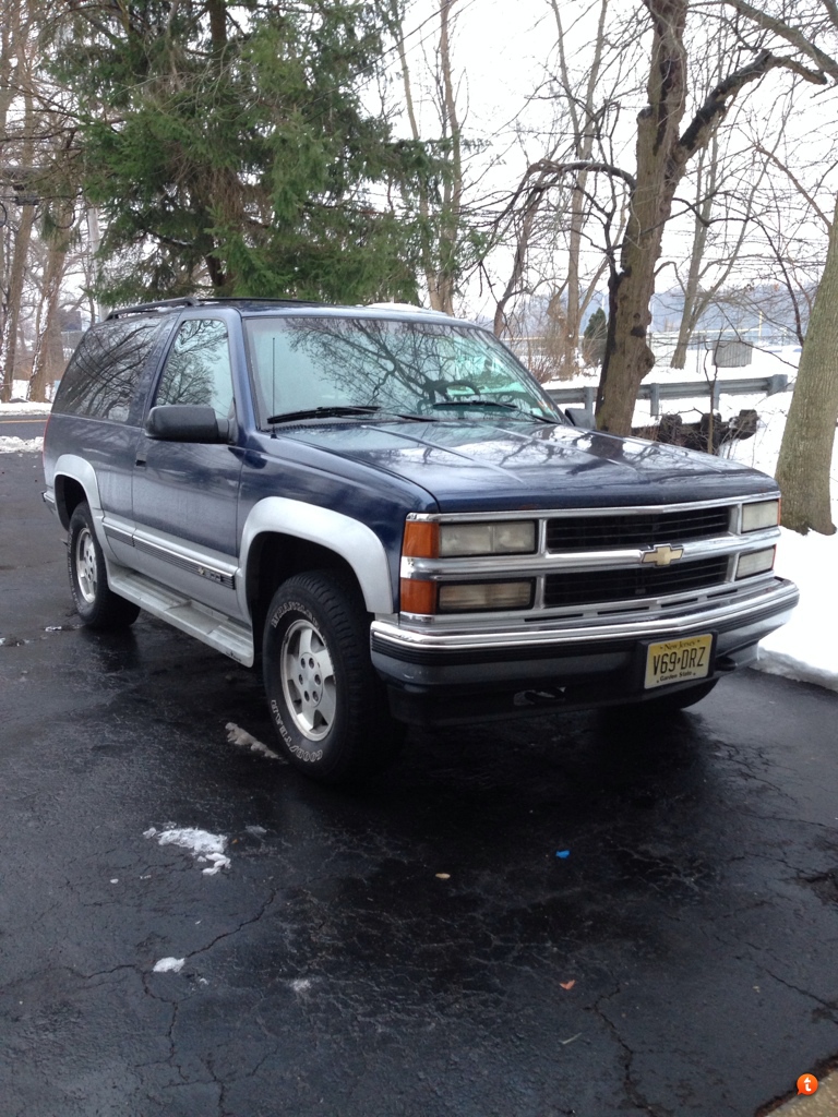

I heard the newer engines have longevity issues with the coils. That's what lead me to buy a 95.

It'll throw a code alright. But check the plug to see how it's firing and compare it to another. It might be time. They get weak over time. I'm going to swap mine out when work picks up. But being I have a 95, I only have 1- and at 243k, I believe I'm on borrowed time aswell like you.
