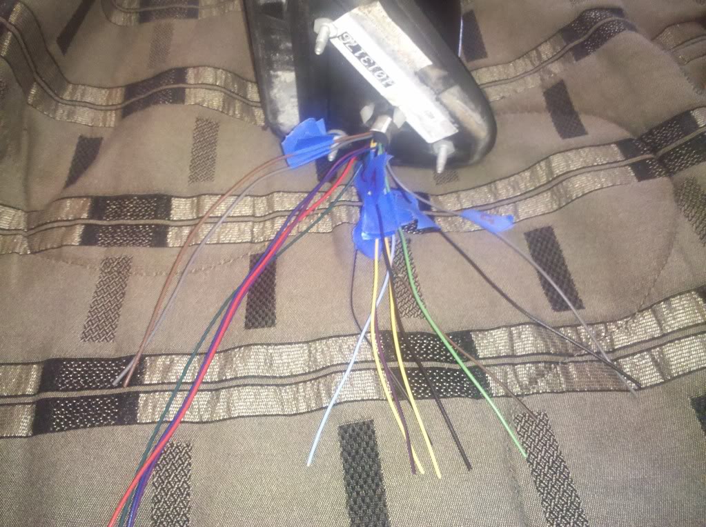

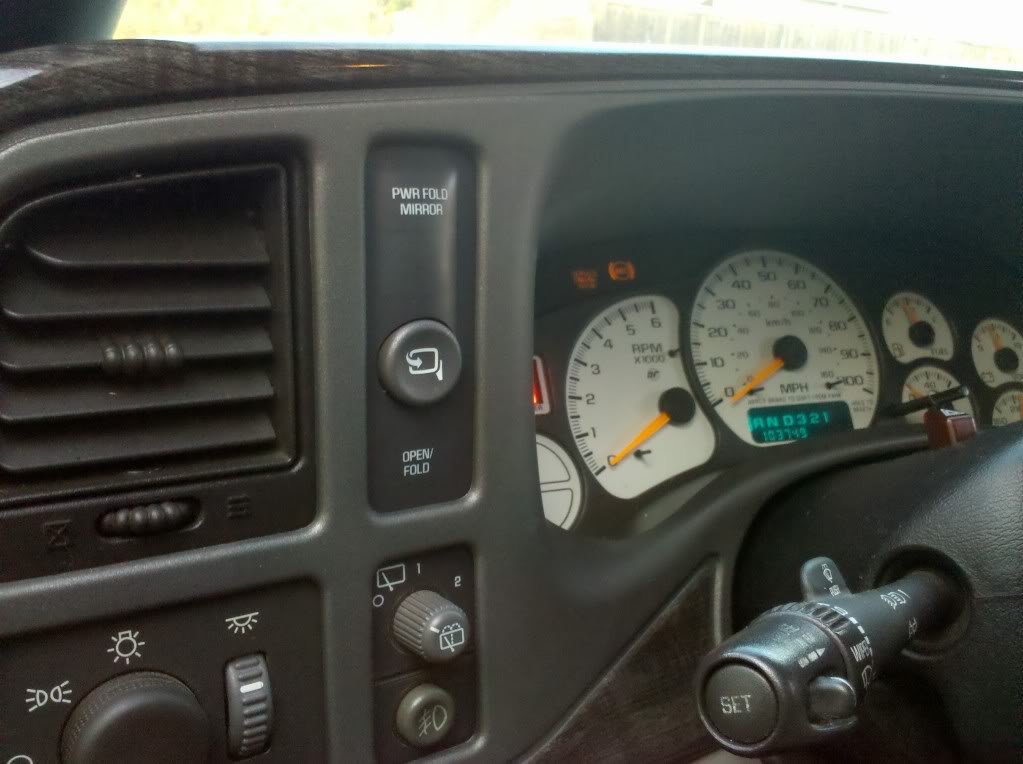

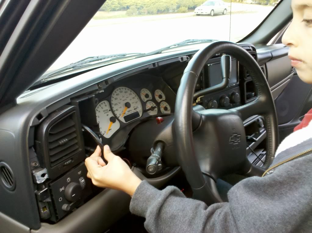

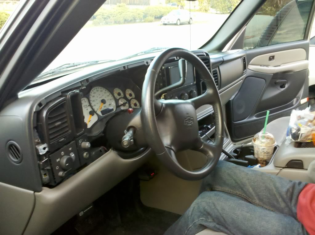

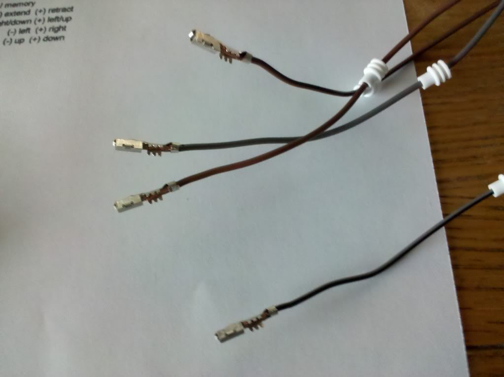

You can also add power folding mirrors to 99-02s as well. I did it on my 2001 Suburban. You'll need a 2002 Escalade power folding mirror switch and to do a little wiring.

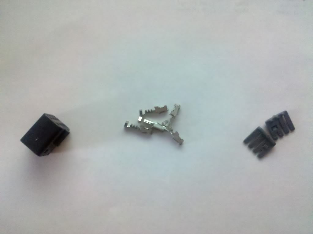

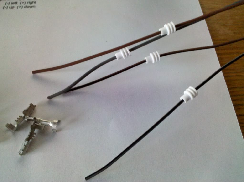

The mirrors came out of a 2006 I believe and as most of you may or may not know, the electrical connectors are different. So instead of just cutting and splicing wires, I purchased some OEM connectors and made the 2006 mirrors plug and play into a 2001.
I refered to this thread for the wiring:
http://www.gmfullsize.com/forum/showthread.php?t=200970&highlight=fold+mirror
Here's the pictures. I'll be happy to answer any questions that anyone has.
