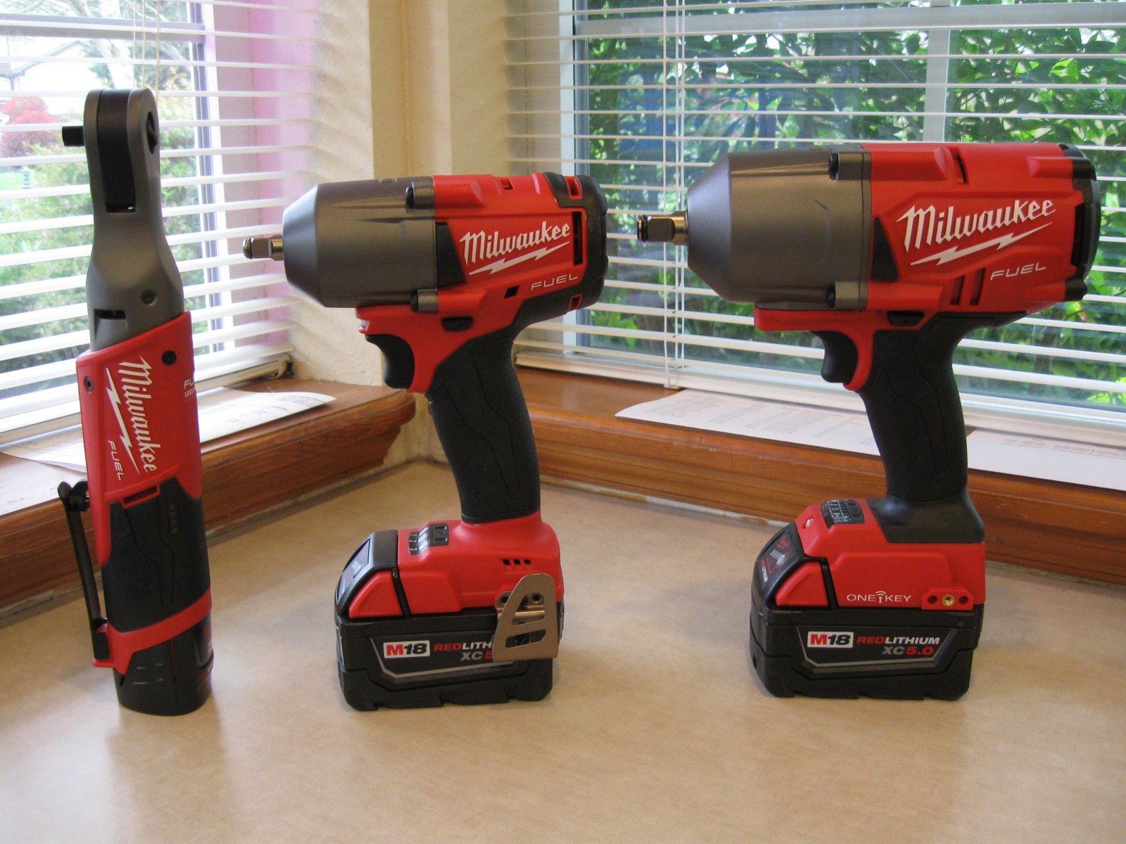

Just picked up my recently purchased set of Milwaukee Battery Powered Tools. The first in line is the right angle 3/8" ratchet, model #2557-20, at 55 ft. lbs. of torque which as we all know is not for breaking things loose but to roll out or in quicker than by hand. I can get and will get a more powerful battery for it for more speed and power. I just want to see how it does in its stock set up.
Next is the 3/8" impact, model #2852-20, that has 600 ft. lbs. of torque and again I can get more powerful battery if want to.
Next is the 1/2" impact, model #2863-20, that has 1400 ft. lbs. of torque and I think, not sure, can get a more powerful battery if want to.
They all come with cases and a battery charger and 2 batteries.
I do have air compressor and the full gambit of air tools but wanted to try out the battery powered no air hose to deal with, set up.
Any experience out there with any of these?

That's what I was talking about when I did the search and research for these tools. The reviews seemed to be overwhelming about the quality and warranty for the Milwaukee cordless tools. I will likely be using all three of them during the soon work of replacing a clutch in a 2012 Honda Civic.

The other day I was working on my Harley and was wanting to take off quick connect adapters for the old backrest and carrier assembly. The side struts for the rear fender have three attachments at each side. The middle adapter was held in place with an allen head fastener. I used a long 3/8" ratchet and a good strong Snap-On allen socket. I tried by hand force and I could just feel the female allen head starting to round out on the inside. I broke out the 3/8" new Milwaukee impact. Just a couple of quick burst of reverse and it rattled the threads just enough to break loose and unthread out with no further problems. The claims were right. I could feel the torque, set at max power setting, and do believe that this same tool can be used to remove lug nuts as I have seen in you tube videos. So far I am sold on these Milwaukee tools I bought.
