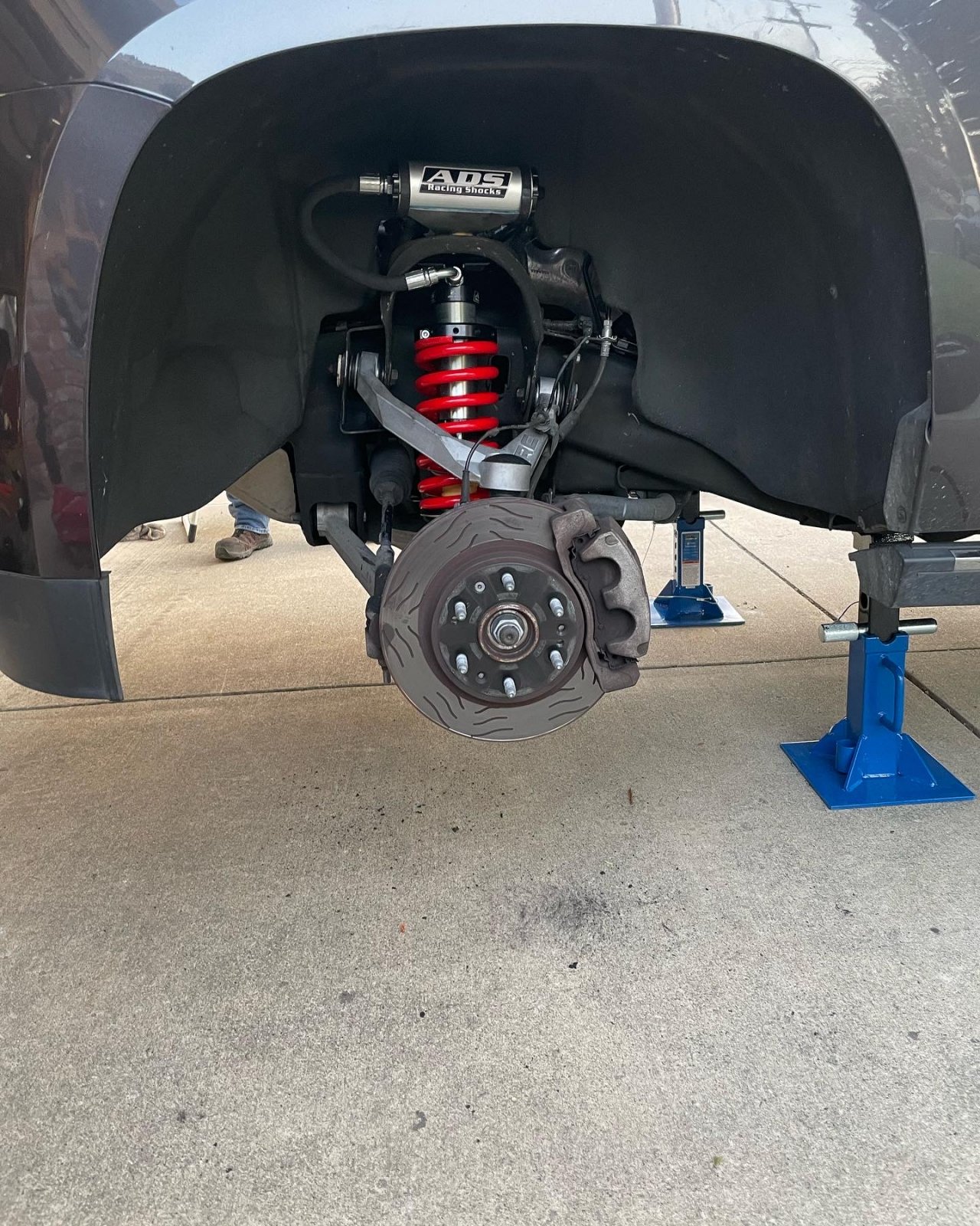

I’m running ADS coilovers up front and piggyback reservoir shocks out back and border patrol springs. And the RC forged uca with high angle ball joint. It’s actually a really good arm for cheeeeaaaap. If I didn’t go with those I’d run the Camburg arm.
If you go the Izzy route, go with kings over icon. Icon is not horrible, but the kings use a better piston design, and rebuilds and repairs are a lot easier and readily available.

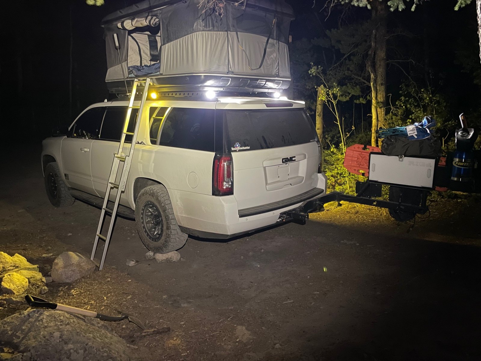

What tent is that? Also, what hitch rack are you using? I like that setup!

I have two tents… the softshell is a 23Zero Walkabout 72. Awesome tent, lots of bells and whistles, California King size mattress. The hard shell is a James Baroud Evasion XXL. I really like it due to the set-up and break down time. Under 5 minutes compared to probably 20-30 with the 23Zero. Good if you’re moving camp often or if you want to get out during the day and then come back to your campsite. The rear tire swing is a Rigd Ultraswing Mega-Fit. I like it.
Yes they keep everything the same, even the CV axles are left stock. They claim you can run 37's with some fender trimming. I don't really have a desire to go bigger than 35's at most.
Thats good to know! I've been debating between a soft shell and hard shell. I think I'm leaning that way now. I like fast.

I just realized on my phone it didn’t show that the rack and pinion was only for the hydraulic era vehicles. A quick phone call just confirmed that they do not make a replacement rack and pinion for the 2015. But they do make a conversion kit to go back to hydraulic and then you can use their billet rack and pinion.
I have not actually installed those coils yet from Dobson. I’ve just been in the process of ordering everything as I’ve researched it. Although with someone else’s recommendation of skyjacker I’m double checking before I order those springs.
The main reason why I decided to go with Izzy was because of the travel. After comparing the other mid travel options I liked how well built these were and the fact that these pushed the front wheels forward an inch and still allowed use of the Stock CV axles.

Great info here already, but wanted to share my experience as it sounds like you and I are on a similar path.
Izzy's mid travel kit is a great option. I saw it in person when I picked up my skid plate from him, and the quality of the parts he and his team build are top notch. If you want to avoid running front fiberglass their mid travel kit is a great option for you.
Izzy did recently release a bolt on long travel kit you might consider as well. You will have to install fiberglass fenders, but that kit is $5k with shocks, and can cycle 13" to 15" of front travel using bolt on coilovers.
Another option is to run something like I have with a replacement UCA and DSC FOX coliovers. We have run the new setup quite a bit offroad and I love it. The FOX shocks are not cheap, but the DSC is definitely worth the upgrade. I thought the DSC was a gimmick until I rode in a truck with them and felt the difference before and after adjusting.
More travel is great but a properly setup shock is essential. Whichever route you take I highly recommend getting the shocks tuned. From what I have gathered the shocks that you buy from any of the manufacturers for our platform are going to be setup for the trucks. The 700lb spring in the coilovers was too stiff for my front end. Even with the preload dialed all the way out the front end sat high, limiting the down travel. With a 600lb spring it rides great.
For the rear I have been running the Dobinsons springs below. Not a huge fan of the color, but they do what I need them to do. With the added weight of the spare tire carrier, sleeping platform, and everything carried in the platform the boost in constant load made all the difference for me. If you aren't carrying all the weight Dobinsons has a standard 2" lift spring available at Baseline Overland as well.
