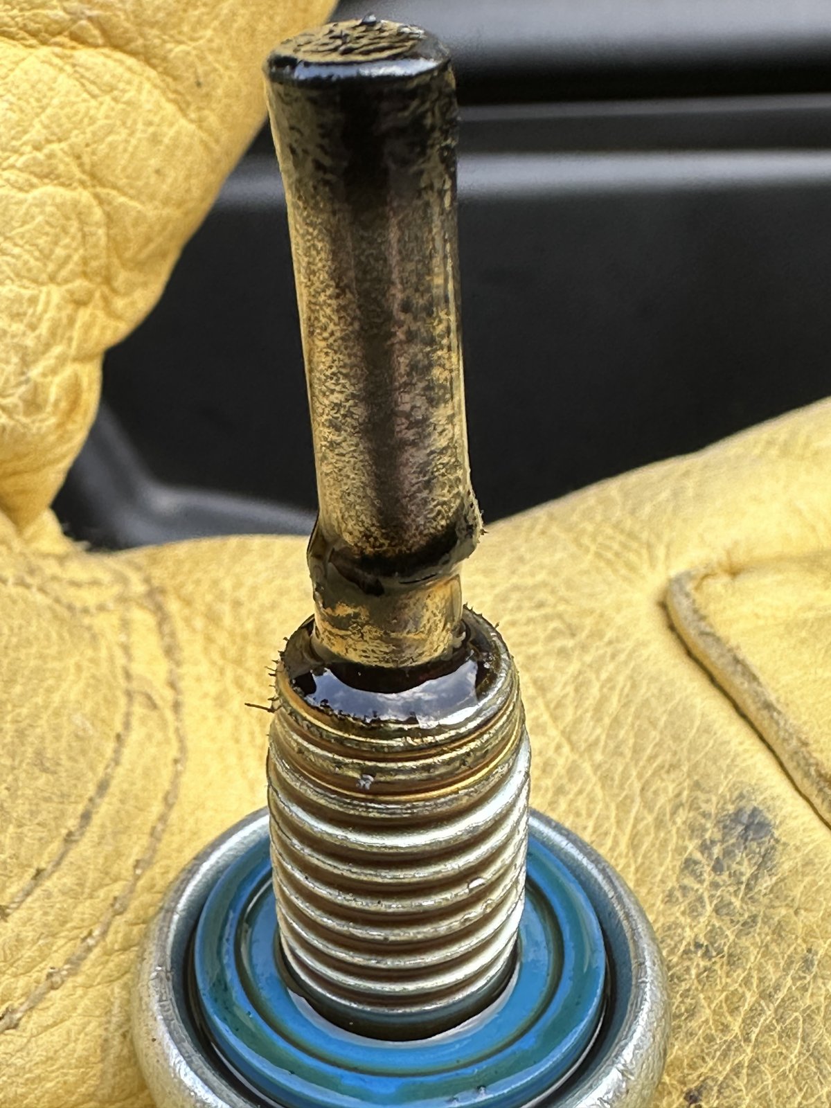

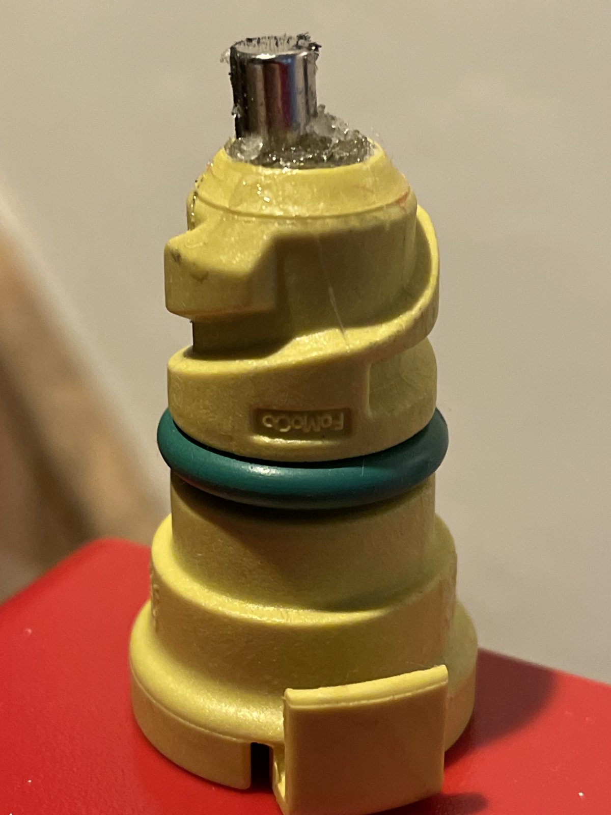

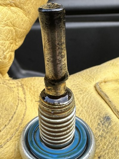

i have had 3 5.3s.. the current 2023 tahoe has 4300 miles on it. at 1k miles i changed out to 5 30 pennzoil... and added a big magnetic on the oil drain so i can see what issues you have with iron. maybe some issue with hardening for instance... what i can say.. this engine is mexico made. my prior '18 was a ny engine. i think the ny was better. nothing wrong with current but the ny engine was really nothing.. on the magnets. nothing... even my 2.7 ford is less than this latest 5.3. we will see how the next change is on this 5.3... i put the ford on there to see...

Ever heard of fiiltermag (line below to what I'm talking about). Seems way less risky that inserting a magnet thats only held in place with epoxy into the actual pan. These just attached the side of the oil filter and retain all the metal in there.
I cut open every filter to inspect the inside after an oil change anyway (using a tool similar to the one linked below) and you can see the filter mags work as there are distinct lines of crap on the inside right where the magnets were stuck on the outside.

the magnetic is there as a proxy so you can tell based on one change to the next.. how much iron is in the oil. i have these one every motor i have. tells you when the product is ready to be sold..

Until the epoxy comes off and clogs the oil pickup tube screen or the magnet gets caught up the rotating assembly after it falls off the epoxy anyway.
