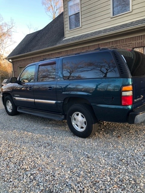

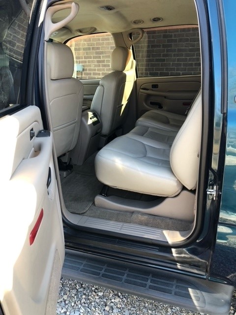

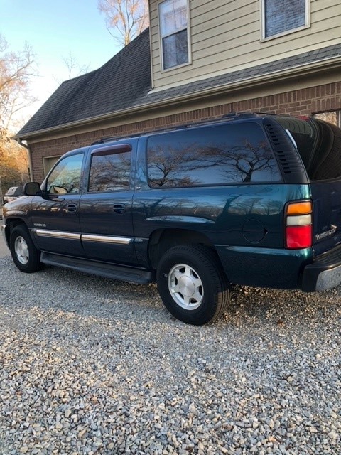

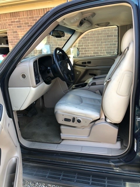

I'm considering purchasing an 05 Yukon XL SLT with just over 145,000 miles. It has lived in the south all of its life and is in great shape cosmetically.
What should I keep an eye out for in the guts?
My understanding is the 5.3 V8 is stout and the transmission is pretty good too. So this may have a lot of life left in it. What do y'all think?

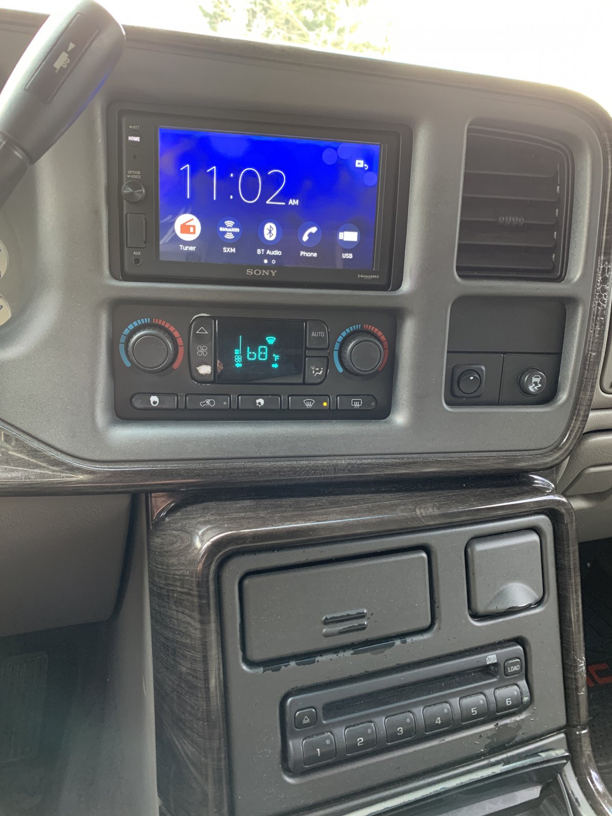

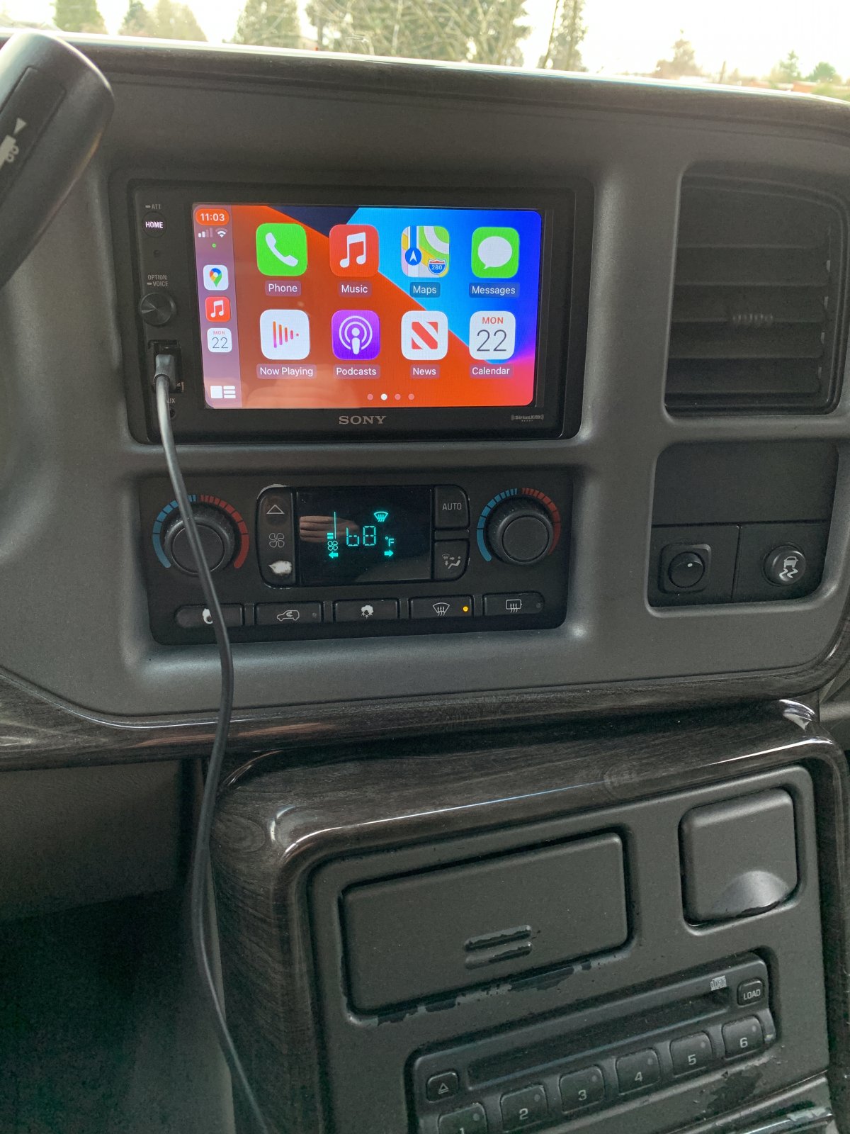

Now contemplating a radio upgrade to get Apple Car Play & a backup camera. Let me know if you have any pointers. (I've found a few on youtube)
Congrats! I have a 2005 Yukon XL Denali that I purchased used at around 150k miles. It did have the transmission rebuilt just before I got it. So I would just plan on that and set aside some $$. This is very typical and one of the weak points of these rigs. Also, just replaced the z55 autoride suspension which was $3k for OEM parts and installation. Yes, I could have went a cheaper route with aftermarket parts or frankensteined it with a conversion kit but I want to keep this for awhile and wanted everything back to as much stock as possible the way it was meant to be. And the exhaust system needed to be replaced which was about another $700. I went with a nice Magnaflow system and it sounds great.
Also, upgraded the head-unit w/ Apple CarPlay and a back up camera + XM radio. All in that was $700. Got the Sony XAVAX1000 model.
https://www.bestbuy.com/site/sony-6...-media-receiver-black/6283607.p?skuId=6283607
Here are some pics. 100% happy with it and totally recommend!
