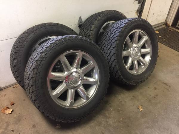

https://saginaw.craigslist.org/cto/5929019429.html
I like the way this Denali on 20x12 with 305/55/20 looks.
While I, on the other hand, despise the way the tires are stretched out. On 20x10's, they might look ok. On a 12" wide rim, I'd at least go to a 325/50/20.
I've got some 20x8.5 GMC sierra wheels, and I'm debating on going tall and skinny (295/65/20 - 35.4" x 11.6"), a little wider (325/60/20 - 35.4" x 12.8") or running 35x12.5x20 (about 34.6" x 12.5", comparable to a 315/60/20), or a little wider 35x13.50x20 (34.6" x 13.5" - close to a 345/50/20).

I think any of them would look f'ing great on these!
(The tires are 305/50/20 General Grabber ATII's, about 32")

Not sure what stretched your talking about. Tires look fine to me, 12" wide rim with 12.5" tires... no stretching :2cents:
The pic u posted, Those rims n 305/50/20 tires looks goofy on a skinny 8.5" wheel if u ask me.like you had to squeeze them on the rim and they could pop off.
