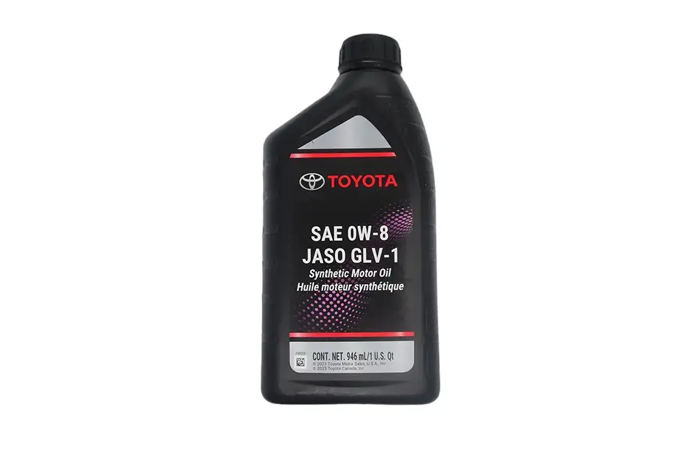

0w20!?
What'll be next?
Toyota already has a 0w8 out and is putting that in some of their cars.
Yes an 8 weight oil at operating temperature, makes the 0w20 slippery water crap GM specs for us look like actual oil by comparison.
