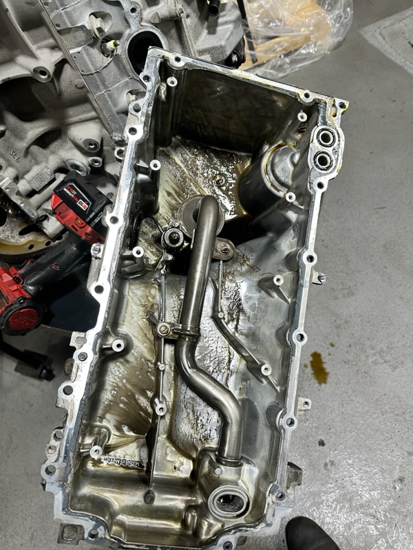

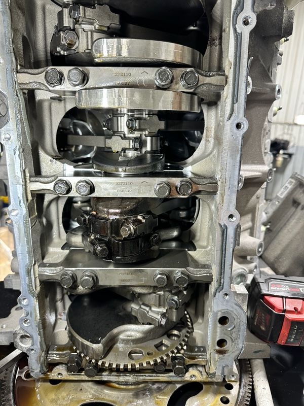

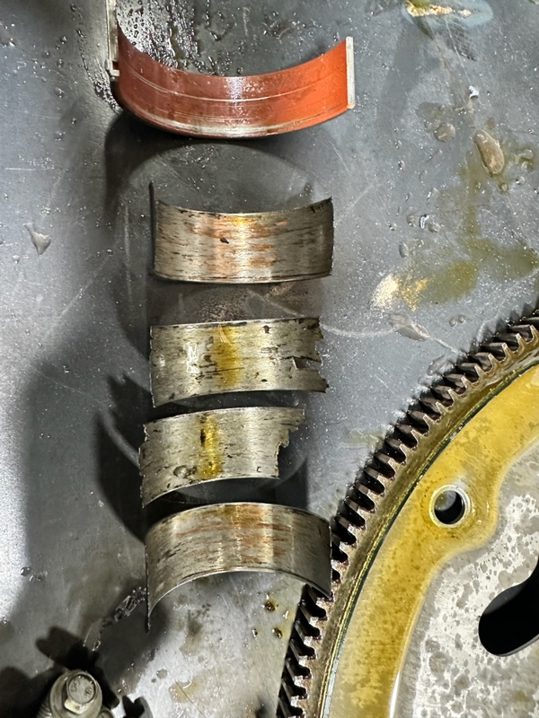

Update: Parts arrived, they replaced the motor and were trying to put some miles on it and check everything over and the starter started acting up. Ordered a starter and now it is on backorder. :banghead:
Dilligaf34
Mar 21, 2024
12
8
New update, they replaced the starter and fuse box. Picked it up late Friday 5/10, over the weekend it lost throttle for a split second or 2 several times, stalled a few times and than the engine light came on(BTW, I put 110 miles on it). Took it back Mon. 5/13 they checked it out and said it was losing the reading on the reluctor for the cam. Gm advised them to do a further tear down, there they found that the cam was moving so much that the reluctor on the cam gear was hitting the timing cover. They are now waiting for GM to tell them how to move forward. They currently have 5 trucks that need new motors and 2 other trucks that have had new motors fail. GM WHAT A F**KING SH*T SHOW.
