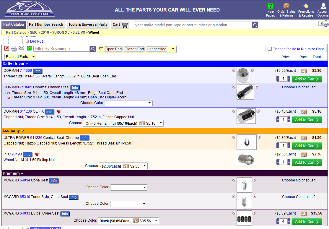

Just stay away from 'capped' nuts. The last three in this graphic are solid. Others can be found on eBay, Amazon, etc.:

GM sells solid lug nuts that are nice. I used to be able to pick up a set on eBay for $30-50 but my last set cost me $82 but included a lock set. These are a dramatically better lug nut and I have a rubbermaid tub with hundreds of the crappy capped variety.

Just in case anyone else was curious here is the OEM capped variety right next to the OEM solid chrome variety. Both are 22mm but one sucks and one doesn't. I added a capped lug nut to the wheel in the second picture to show how easy it is to tell them apart in person. The capped lug nuts are rounded top and sides and continue to round if the cap itself doesn't begin to fail while the solid lug nuts stay nice for a very very long time.
If it also wasn't clear, this is a multi-hundred dollar lug nut set if you buy it new. I'm not sure of the price but I'd expect at least $200 new. A lot of dealers like to spec these however to add to the sticker price and then people immediately go to the tire shop and get cheaper crappier aftermarket lug nuts for their new $4000 rims and the tire shop lists these lug nuts on ebay for half or less.
