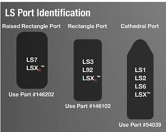

General Motors produced seven versions of the LS engine, most of them with different heads. You can identify which head you have by looking at the three-digit stamping next to the valve cover; for example, the LS1 used head castings 339 and 806 through 1998, and 853 and 241 from 1999 through 2004. The 243 head came on the more powerful LS6 engine from 2001 to 2006, and was used in C5 Corvettes. Later engines like the truck-spec LQ9 and LQ4 used the exact same port design as the LS6's 243 heads, but had 6 cc larger combustion chambers.
Basic Differences
There are three basic differences between the LS1 and LS6 heads. The first has to do with port shape. The LS6 and the later LQ9/LQ4 heads used reshaped intake ports and D-shaped -- as opposed to oval-shaped -- exhaust ports for better flow: 200 cfm intake and 70 cfm exhaust for the 241's, and 210 intake and 75 cfm for the 243's. The second major difference is that the LS6 heads used hollow, sodium-filled valve stems for reduced valvetrain inertia and better heat transfer from the exhaust valves to the head. The LS6's 243 heads also had a slightly smaller combustion chamber: 65 cc to the LS1's 67 cc.

Sell them.
Basic Differences
Thanks for the info!!!
