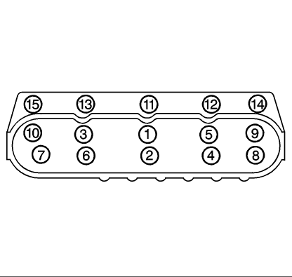

Does someone have the torque sequence and specs for the heads on this 2011 6/2? Can't seem to find them anywhere.

Tighten the M11 cylinder head bolts (1-10) a first pass in sequence to 30 Nm (22 lb ft).
Tighten the M11 cylinder head bolts (1-10) a second pass in sequence to 90 degrees using J 45059.
Tighten the M11 cylinder head bolts (1-10) a final pass to 70 degrees using J 45059.
Tighten the M8 cylinder head bolts (11-15) to 30 Nm (22 lb ft). Begin with the center bolt (11) and alternating side-to-side, work outward tightening all of the bolts.

Thanks Dave. That worked well. What process did you use for the rockers if you can share? Not seeing a good site/video for a novice like me.
