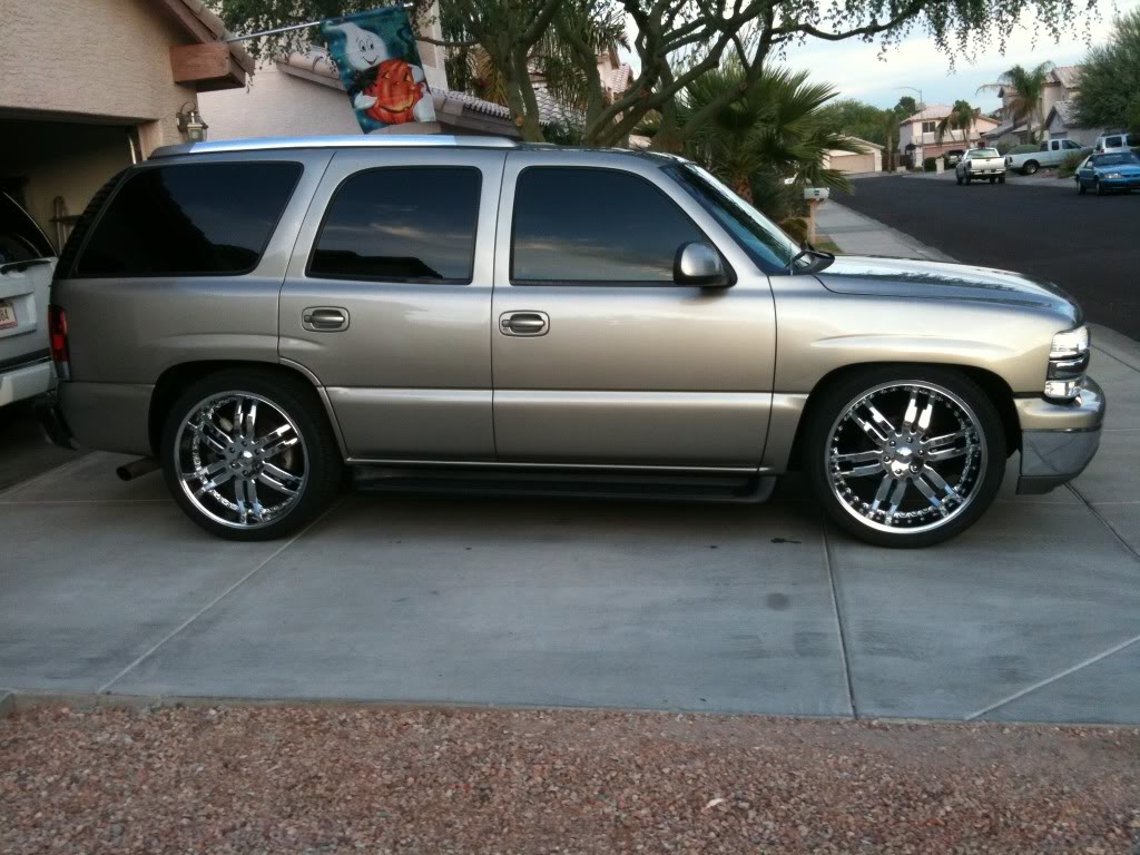

Whats the trick to getting the back lower on a 3/5? I have about a 1" wheel gap still and others i have seen have no gap. Is it going to settle that much? its been about 5 days now. I used the mcgaughys kit. spindles, keys, springs, and axle relocators. I put the stock keys back in to level the truck out, but would like to have no gap all around...
heres a pic...this is with the lowering keys. now has stock keys to bring front up like the rear
---------- Post added at 11:14 PM ---------- Previous post was at 11:12 PM ----------
oh and btw i dont have the rubber isolators in and also installed mcgaughys drop shocks.

It might take it a little longer to settle, the only other thing you can do if it doesn't settle anymore you can try a 1" body drop to get the look your after. I'm sure others will drop in with some advice on this!

5 days should be enough to settle. Do you have shock extenders as well?
Remove rubber spring isolators as well... it's good for 1/4 inch to 1/2 inch
That's about were mine sits as well...

get rid of those, while McGaughys is a superior product, their shocks are junk. Get some Bilsteins...

i have that same kit on my denali, and im having the same issue. front is good cuz u can still go lower but the rear needs to go lower, and its all in the spring dude, cuz i let the truck sit with no shocks, just the spring and stayed at the same height. but there is a resolution, the qa1 springs i was gonna get them but i decided to bag my rear, ''set n forget'' thats putting bags in, leave them set at a certain psi and dont sweat tankk and compressor ect till u have the money. if u wanna go with the spring check out the thread djm started. im gonna start a thread on my project.

What shocks you guys running? I need front shocks too and some bumpstops...I am riding on the bumpstops up front and shocks are leaking...whats the recommendations?

Bilsteins!!! I cut my bump stops by half and it rides smooth.. I have aout an in inch of gap

PLEASE PM ME. I use the qa1 springs in rear and the are only 39 bucks and will get you what you need ifyou need lower.
What rear springs are you using the djm rear 5 inch springs sit pretty low.
