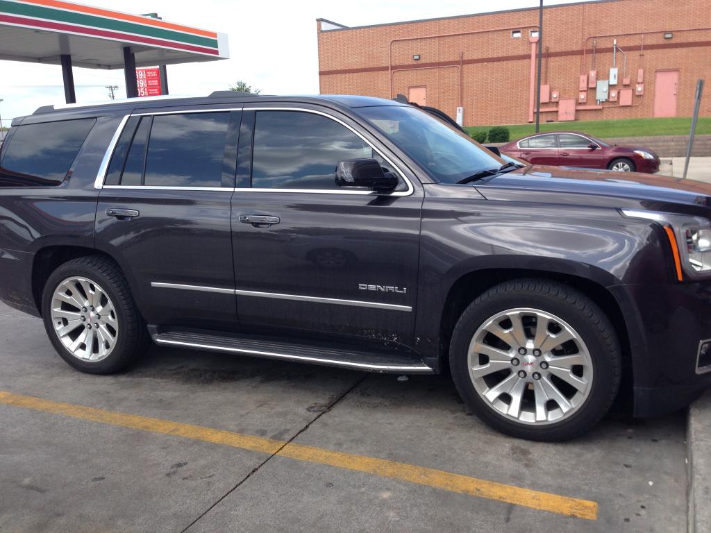

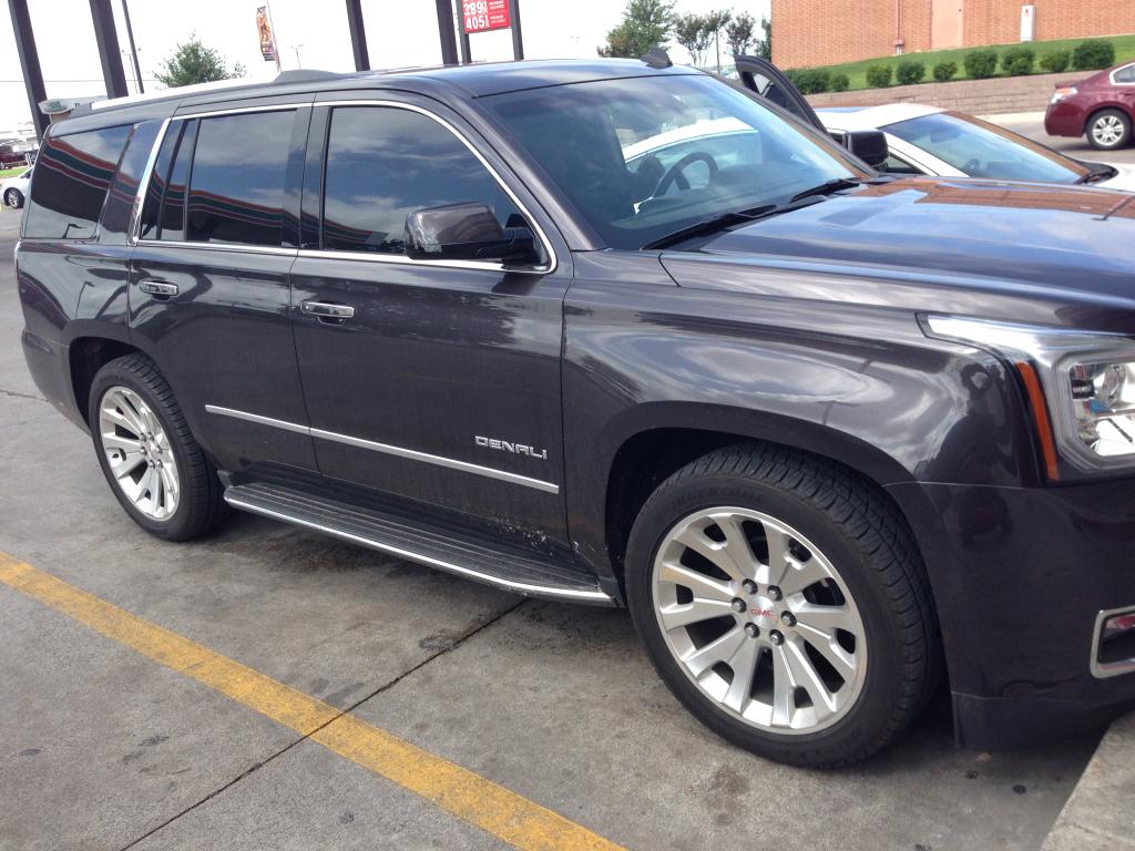

Just spotted this lowered 15 Denali. Looked great. Still trying to talk the wife into lowering ours!!

The rear works but not front. I can still do my strut mod but im waiting on belltech to come out with spindles.
Front lip is lowwwww in tbat pic
