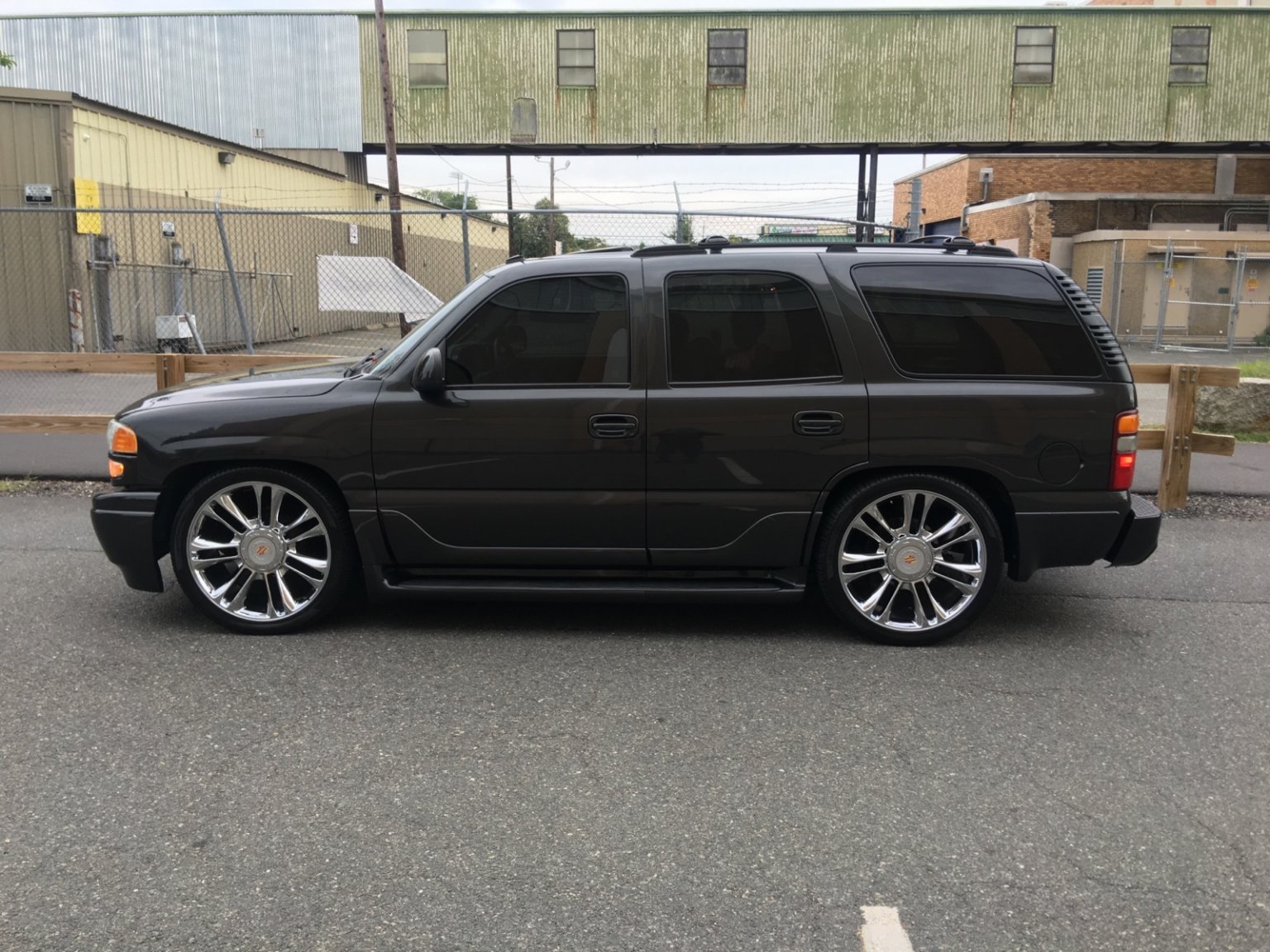

man those shocks suck. Wish you spoke to me
I used the Street Performance Belltech shocks on my S10 and loved them but I read a lot of positive comments about the CalMax shocks as well. We'll see how it goes! I'm reconsidering the Spohn bar bar tho. DJM told me it wasn't necessary.
Ghostl7
Jul 13, 2016
18
22
Corinth, MA
The whole kit is on. DJM lowering arms, rear arm kit and sway links, also the DJM shocks. Everything worked well except the shocks. NorCal is 100% right.. DJM calmax shocks are crap. Im searching for Bilstein shocks. I didn't cut the old bump stop bracket off the rear of frame, and it hardly ever touches the axle. The front aligned perfectly. I only scrub at full lock in front with 305/35/24's. If anybody has info on bilstein shocks on a 4" lowered Yukon/Tahoe. Hit me up

The belltech sp with my custom springs ride great. The djm rear springs will ride ruff. Give it about 2 weeks time you will see

I will sell you 2 brand new in the box Street and Performance Belltech shocks for the rear shipped to your door for $80. Part #2410FF
I'm actually using Truxxx 4" coils. I bought them last year and they aren't terrible but with the Belltech Shocks or Bilsteins it'd be a good ride.
I'm going to hold off for a bit to try and find some Bilsteins that will work. They are expensive but have never been disappointed with their products. Thanks tho.
