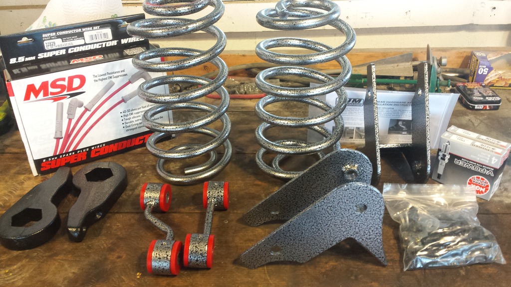

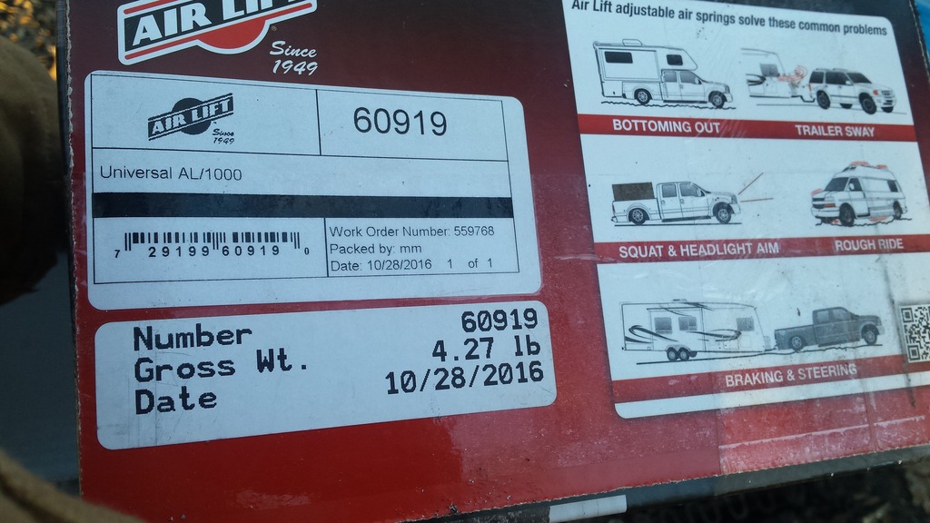

I did a djm 2/3 drop, with regular bilstein 4600 shocks. I then substituted the 2" drop keys in the front for ebay 2" drop spindles and am running stock keys. I deleted the electronic shock feature and deleted the non working rear air lift compressor in favor of manual air lift air bags for $100. Much simpler, ride is nice, and I manually control the rear lift for towing or around town driving.
All the info is here, but you have to scroll through it all to find it
http://www.tahoeyukonforum.com/threads/yukon-down-awd-delete-headers-converter-etc.81191/
Heres some highlights
