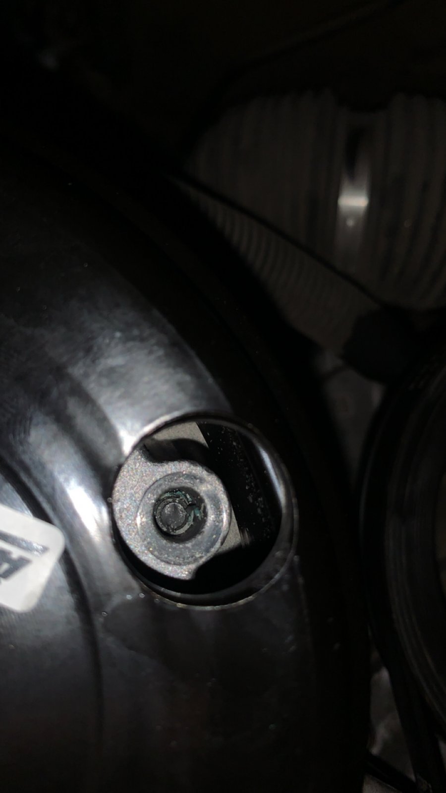

Well, the parts were swapped, but 2 bolts snapped while replacing the water pump pulley. The old one had a bit of play, and the new one does not although its missing two bolts, the play is less than before. Any tips on how to remove broken bolts from the engine block? Are the water pump bolts supposed to be replaced as well? I tried to torque them to 7 ft lbs with a torque wrench from HF but I think its not accurate below 10 ft lbs. I dont have pictures, but one bolt snapped almost all the way, and the other less than half.

Pictures attached.
I installed this part- can't tell if its real or not, but it didnt have a metal gasket. The material is like cotton or paper, would anyone recommend changing the gasket to a metal one? I wanted to use the old one but it was warped.
Would it be a bad idea to drive this thing like this? I don't want to get stranded on the road with my lady and our 1 yr old.
I drove to the gas station by myself last night, all seemed fine. Temp gauge climbed up quick but not alarmingly quick. Just seemed abnormal to me, unless the "heater burping" method boils the coolant and makes it reach operating temps faster?
I topped it off with distilled water at the gas station, let it idle for a bit, fueled up, then drove home with the heater on once again.
Surprisingly, everything in the engine compartment is quiet. Couldn't check for leaks as the plastic cover was soaked with coolant. I'll turn on the truck and check for leaks later today.
Anyways, any input is welcome.
