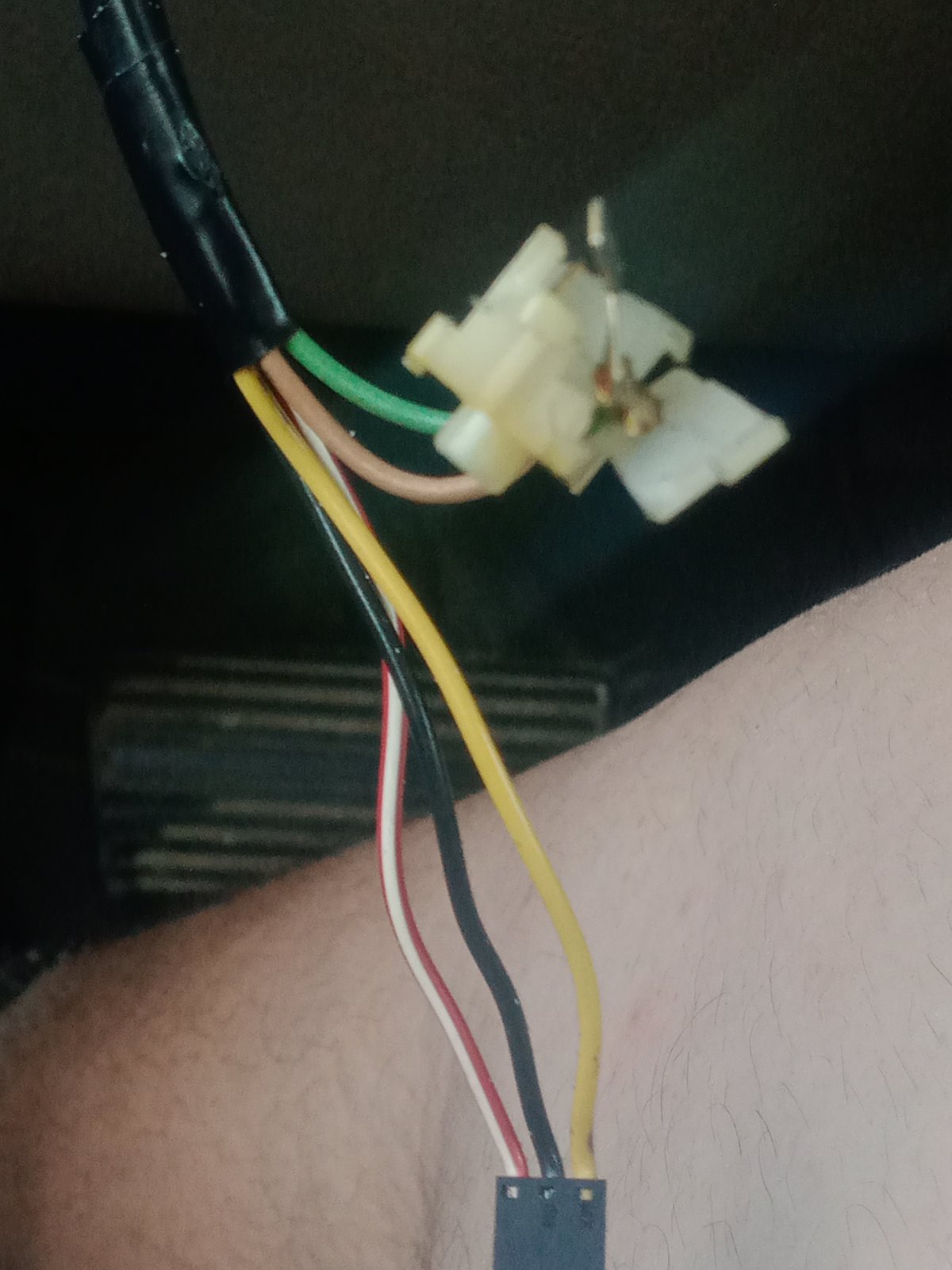

Long story short I lost my keys and I'm about 3 hours away from home I'm able to start the truck and everything but I need to know how I'm supposed to hook up these three wires what I'm supposed to do with these two wires until I can get to the house and get a new ignition cylinder how housing and ignition cylinder itself if anybody can help me out I really appreciate it cuz I've been sitting here stuck here for almost freaking 8 hours now

Start and everything? Or just crank and stall? I thought the 3 wires were for passlock. Red power, black ground, yellow signal, all going back to the bcm I think. So if you can’t keep it running, and the security light is on, that’s why. Without having it plugged in and the ignition cylinder turned I don’t know of an easy bypass.
The other 2 wires I think are just the key in ignition chime… or maybe key retention… either way I don’t think the other 2 should matter for you right now
