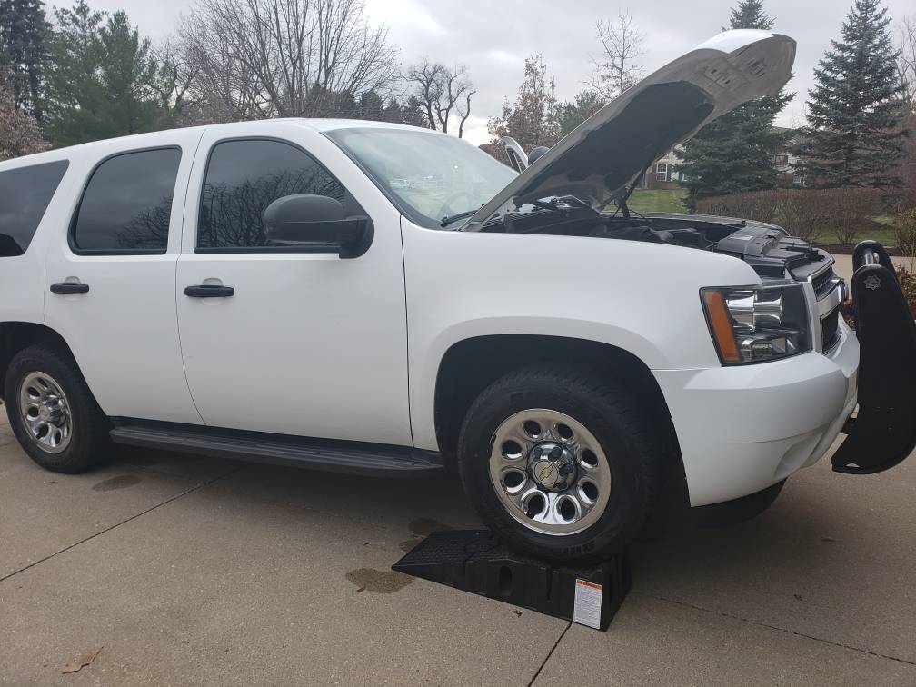

My 2012 is having a problem. It'll get to operating temp from cold, but little to no heat. Once I drive, I'll start getting some heat, but the temp comes way down, and then I largely lose heat (lukewarm). After reading your thread, I replaced the thermostat (which was fully closed when I pulled it) with no change. Something else I noticed is I could open the overflow tank while hot relatively easily. I'm pretty sure these systems rely heavily on pressure, so I replaced the cap. Still no difference. Not sure if my issue is the same, but it is bizarre...
I put 1,200 miles on it this weekend throughout the frozen north. My wife was not pleased with the lack of heat.

Thanks for the hints. I looked over everything and compared it to the service manual. Physically it's all good. I did the bleed procedure, although I didn't add much coolant. If I still have issues, I'll hook up the scanner and check out the actual temps. I also hit the hoses and thermostat housing with my IR thermometer...
