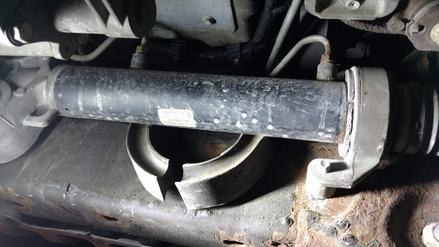

I ended up going under and checking out the new bushings. Had my daughter turn the wheel while I checked on the bushings. They certainly do move. Granted its nothing like the warn out ones but, they move.
There's got to be an aftermarket options for these.
I am real curious how a solid mount would work on the steering rack, especially for every day driving nothing crazy.
I understand about wear and tear but seeing how they're bound to fail out the box, I just think there's got be a better option.

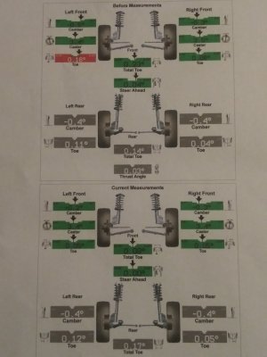

Third alignments a charm :)
I was able to hang out with him and go through the whole front end too, so far so good.

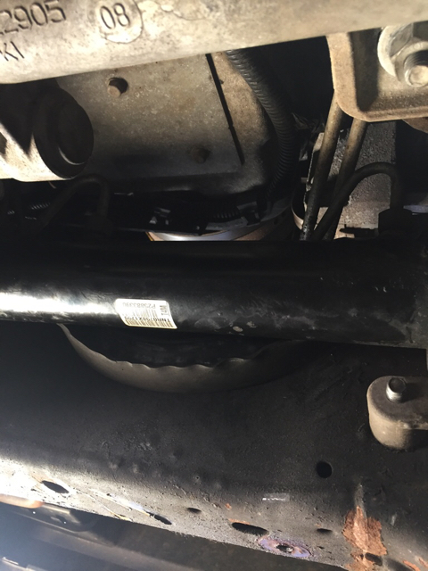

Well it’s deff not air in the p/s system. Either the pump is shot or it’s a bad rack. Spoke to the installing tech and that son of a gun hooked me up with a NEW AC Delco rack, not a reman. That means it’s prolly the pump.
My 4 year service contract just ended. Might have to actually pay for my 1st repair since ‘14.
I did find a solution for the racks that are moving. It’s an poly bushing that won’t deteriorate like the oe material.
08 Denali AWD. Waiting to see if it’s air, p/s pump or the rack.
Do you have a part number for the AC Delco rack?
That bushing will help some but the problem is with the two bushings that bolt in on the drivers side. It would be nice to see an aftermarket bushing to replace the weak rubber ones.

Negative, not even on my invoice. I will get it eventually and post it here.
ls1frc
Aug 10, 2019
923
1,352
So did you have to remove the rack to press the bushings out and new ones in or did you do it with the rack in the truck still?
