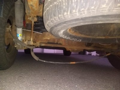

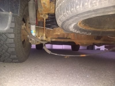

Hey Guys,
So i noticed today that my parking break is hanging low. I want to clip it back into where its suppose to go so it does not get snagged on anything. Does any one know where the clips are for the cable located?

looks like its fallen out of its clip up there. you'll have to get under there and look up you should see something where it came from. then zip tie it back up if needed.

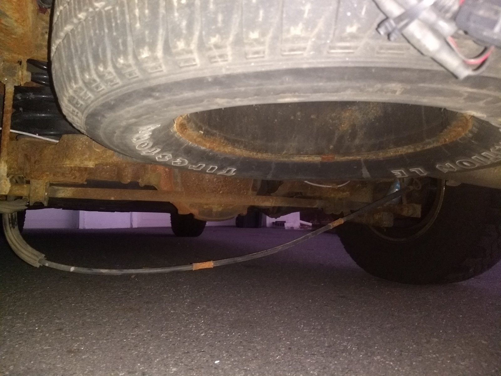

best pic i got of them cables, it turns up hard behind the spare tire.
https://photos.app.goo.gl/ZFzNoWm9ydX6TYMo8
30,765
48,460
ya that's what i'm thinking rusted and gone, you should be able to order one online pretty cheap maybe rockauto or ebay
