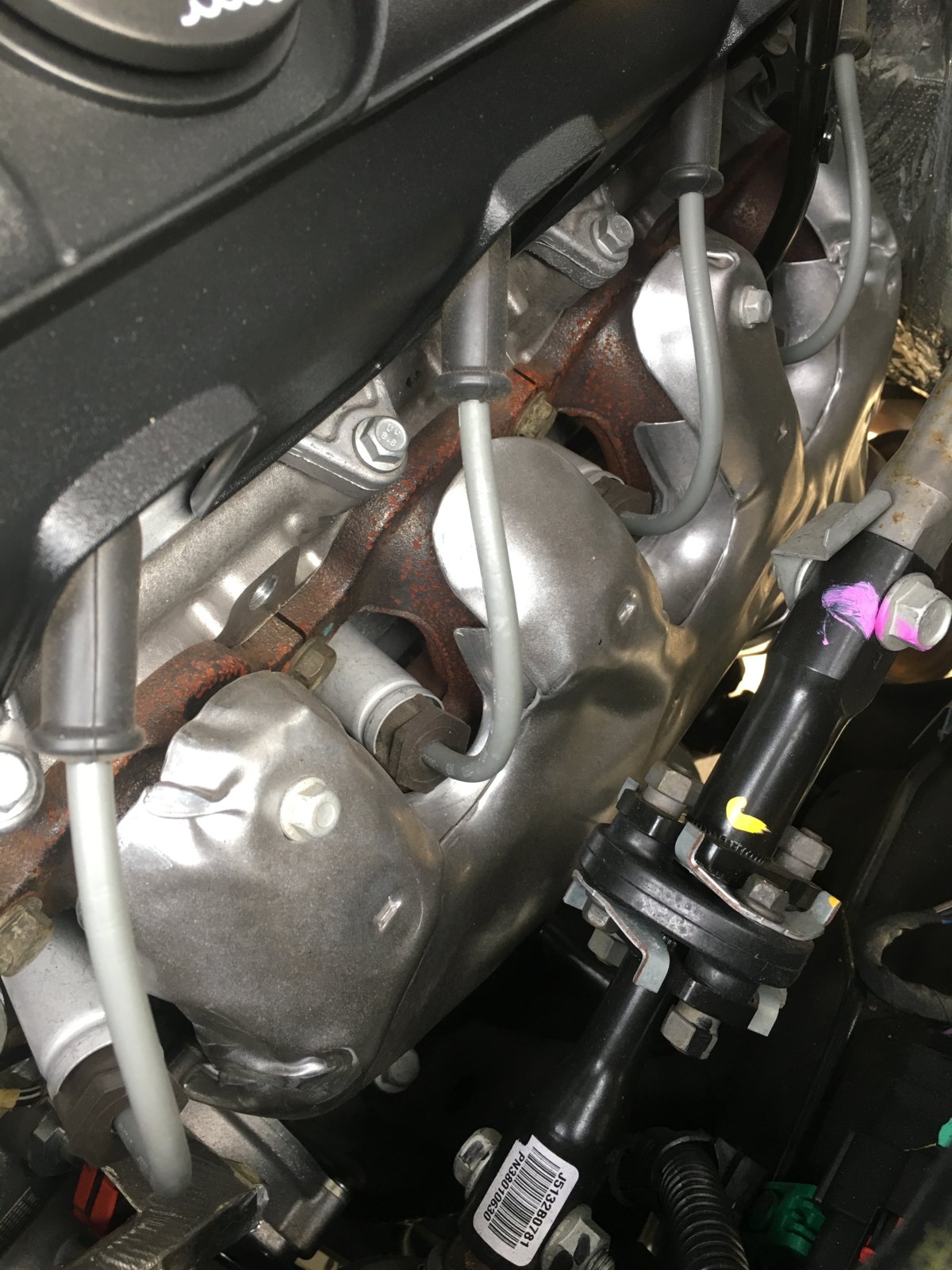

I'm about to buy a 2015 LTZ with 16k miles for $49k...seem like good price. The truck is like new. These cracks above the bolts are concerning. Is this the way they are supposed to be?
That manifold is cracked. Definitely needs to be replaced. Those must have been a rough 16k miles or there was a defect in the casting. Do not buy unless the seller is going to cover the cost of replacement or is going to replace the manifolds.
