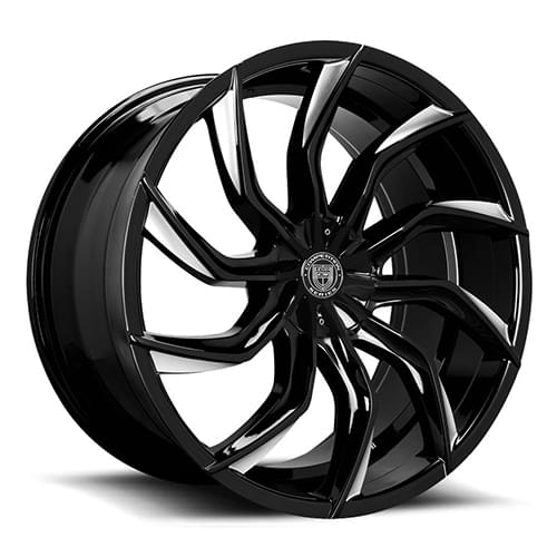

I understand that the wheels are 22x9 with an offset of +25 (or is it -?). I like the look of the Laxani wheels out there, and some of them look like they would fit. However, I really want the truck to have a slightly wider stance, and woud like the wheels to "stick out" about an inch or so from the wheel well. those pictured below look fantastic, but have a +32" offset. I'm not seeing any wheels like out there that I like with an offset like +12 or so that I think would do the trick. I've heard that hub centric spacers might do the trick, but might not be good for the vehicle.

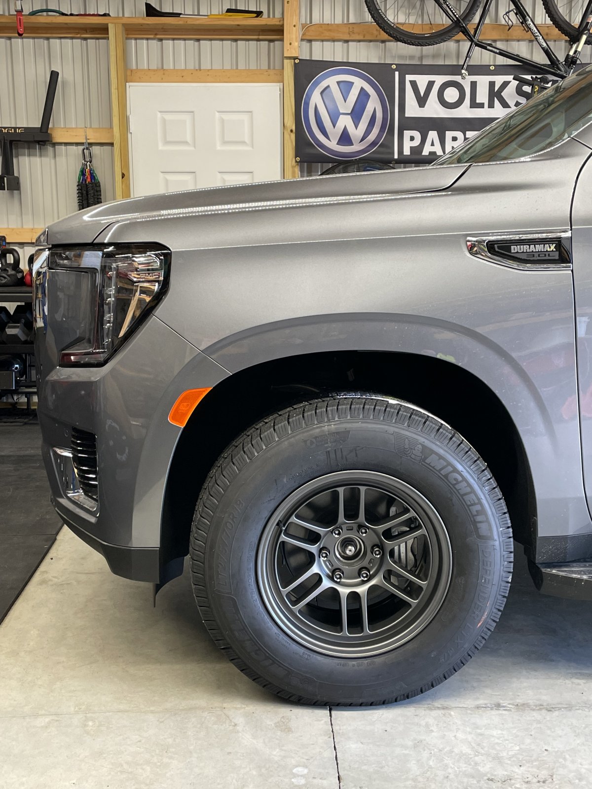

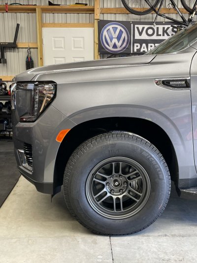

I bought a set of 18x9 RPT1s for my 22 Yukon, they are flow formed. Enkei calls their Flow Formed manufacturing process Most Advanced Technology (M.A.T) and they were about $500'ish each and weigh 23lbs (2105 load rating). Mounted on a 275/70/18 Michelin Defender LTX MS each wheel weighs 75lbs versus the 20" factory wheels/tires for an SLT coming in at 81.4lbs. Most of this weight is tires (52lb each).
Look up the effects of unsprung weight on vehicle dynamics, saving 6.5 lbs a corner is nice, even for a heavy SUV. Doing the opposite is a no bueno. Combined with a low rolling resistance tire I expect to pick up a couple of MPG overall.

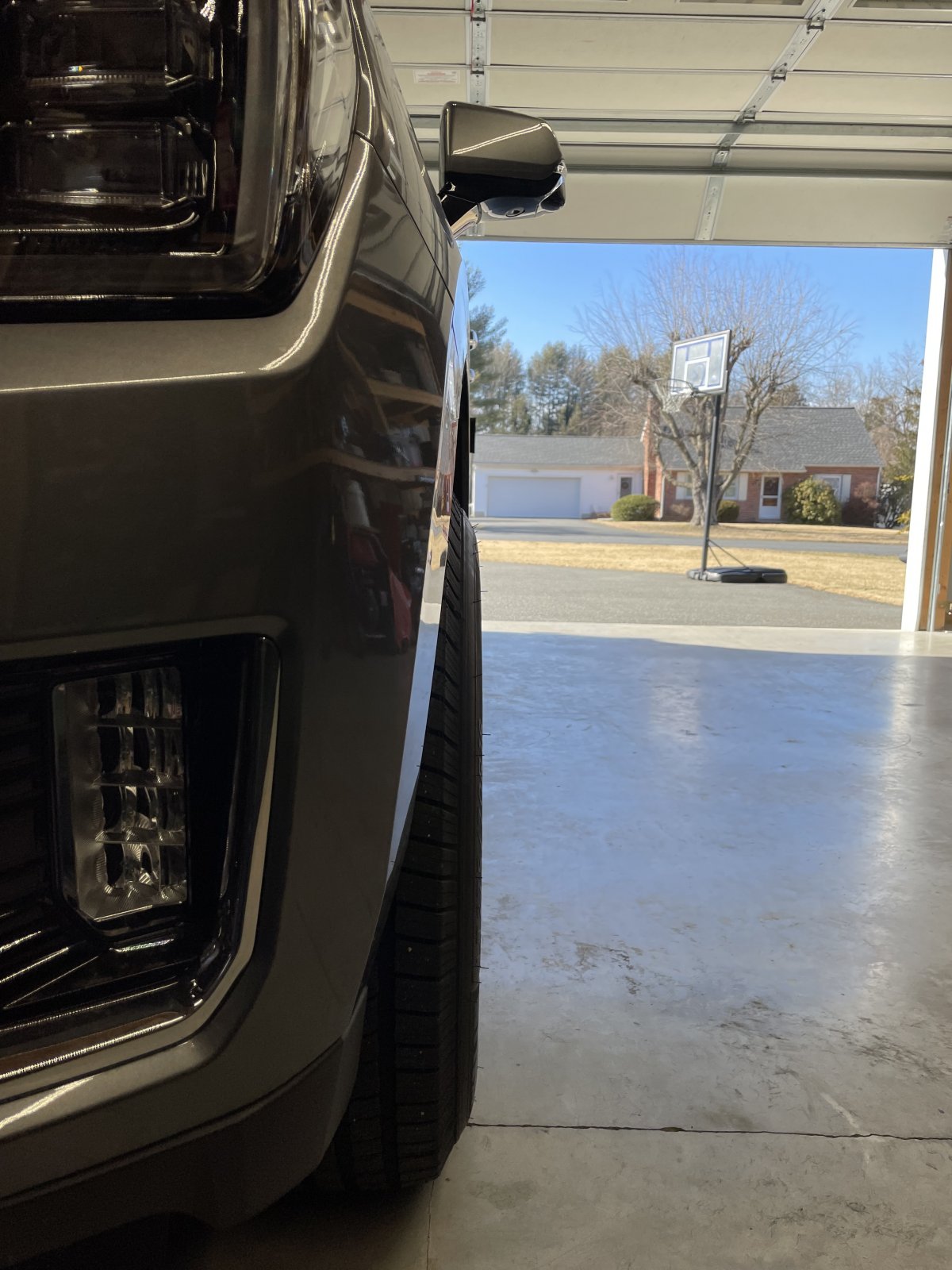

You can always think about going the replica wheel route. Maybe I’m lucky, but have had them in 3 vehicles with no issue. Balanced out great. 1/2 the price of OEM. These are 22x9 +24 offset. With a 285/55 they sit flush with the fender well.
