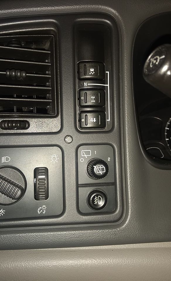

In the picture of the dash the 4wd module has 3 buttons but not the top (auto 4wd). I own both a 2005 4WD tahoe and a 2005 Denali AWD. The AWD has no buttons, it is just a blank in that spot, on the right side of the dash I have a traction control button. I wonder if it is simply 4wd without the "auto" feature.
I specifically asked the guy about 2wd and he said there was no selection.
4hi, 4lo, and N.
Sounds like it's a rare one to stay away from :D

Here's a pic of the truck in question... Wth?!
EDIT: NR4 TRANSFER CASE ALL WHEEL DRIVE (AWD), OPEN DIFF, TWO SPEED
Looks like an even more rare xfer case. Probably want to stay away is my guess.
I just dont understand 3 button selection tho. Can someone explain?
EDIT 2: https://www.gmtruckclub.com/forum/threads/4wd-or-awd.84126/page-2
