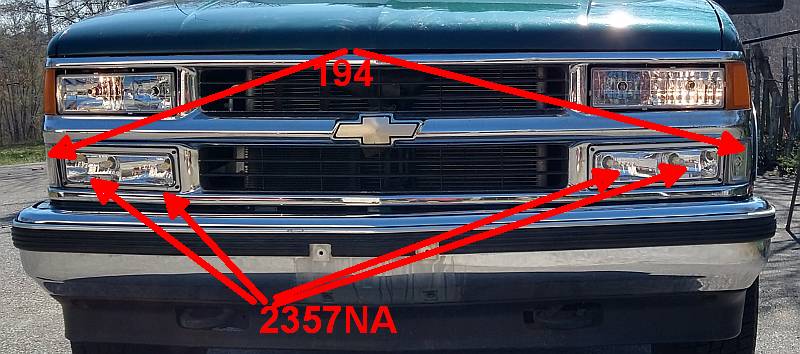

2357NAs for the four amber parking/turn lamps.
194s for the two corner/markers.
98 Tahoe, composite headlight units
