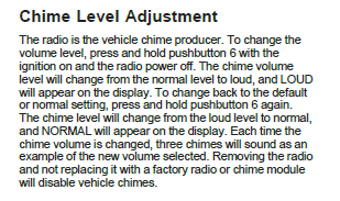

From my '04 manual (check your '05 manual since it may differ) for the factory radio:

My chime is pretty loud, so I am going to attempt this and report back with the results.
I attempted this and it made no difference and neither LOUD or NORMAL was ever displayed. I have my manual and will read thru it.
Second attempt: I did not have the radio turned off the first time. Ignition on and radio power off and press and hold 6. I was on normal and believe me, the LOUD is too LOUD. Back to normal.
