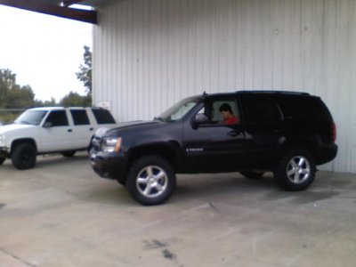

this is a nnbs tahoe on 35s and I believe it just has an rc 3.5 on it in this pic. I think he added a 2 or 3 inch bl later on

^ IMO do not put a spacer on that lift. I would think the CV angles would be too much.
Gonzo and another member are running 35s, but they have the 4-inch Rancho lift.
wbreaux
Dec 17, 2011
105
This. Do not make your angles any worse than they will be with the rc 3.5
