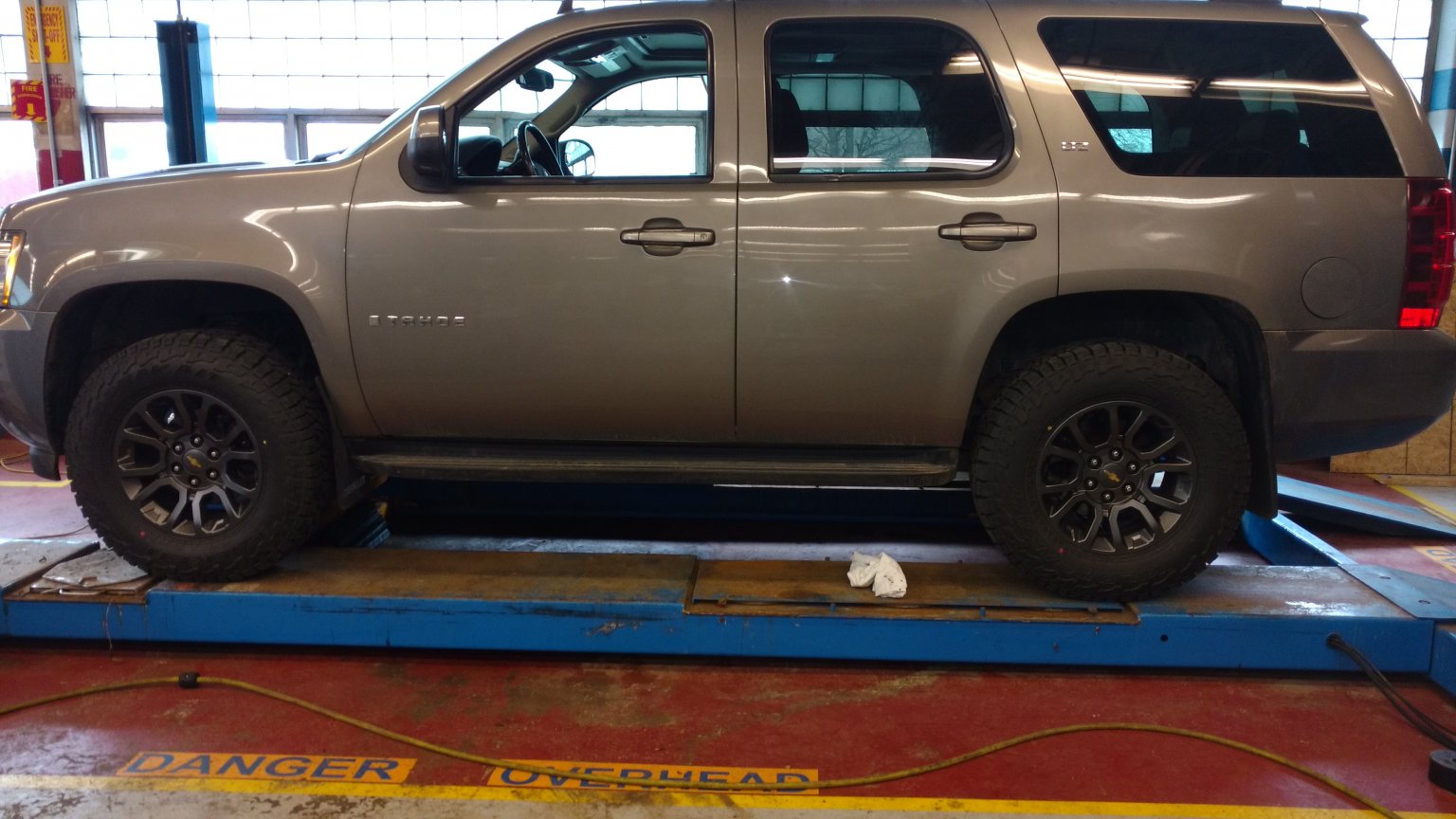

On my 07 I'm running a supreme suspension 2.5 front 1.5 rear. 275/70/18 (33.4) I had some trimming but nothing major. It sitting level once the air suspension kicks in.

Here is a little bit better of a pic from when I did the install
