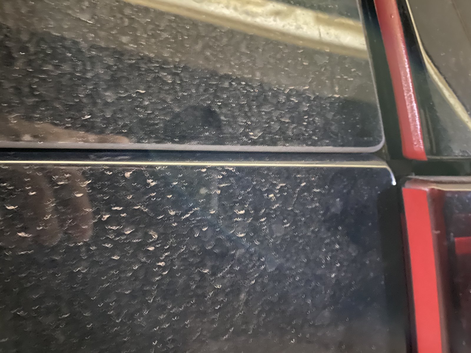

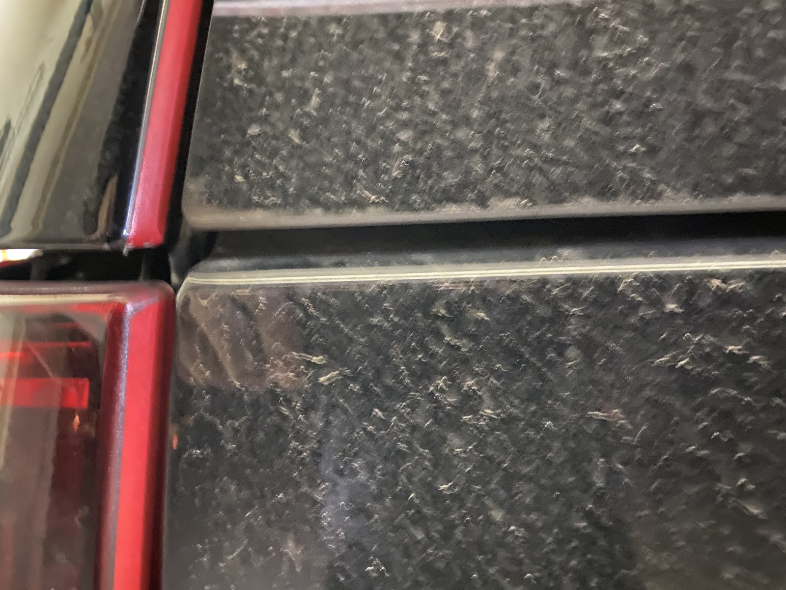

Forgive the dirty hatch, but here are shots of the left and right bottom corners of the glass. The left side has a much bigger panel gap than the right.
