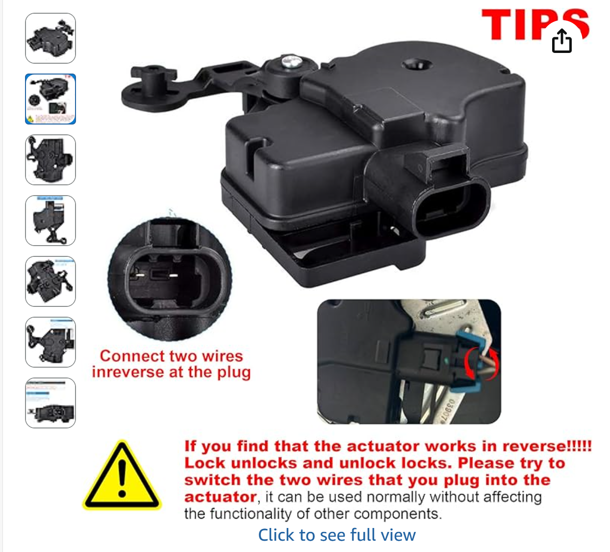

Swap the pins in the plug. it's not uncommon for aftermarket parts to have the polarity backwards. I have seen it a lot of cooling fan motors.
The average Joe on Amazon would not be messing w/ wiring, especially on the truck side, so they are not experiencing the same as I am. I thought about this and tugged on the pins hoping they would easily come out but they don't.

a few listings on amazon say this may be necessary. that's the risk you take when you order cheap parts.
Of course they won't; they're made to stay in. You need a terminal tool to remove them.
If I were you I'd pick up a pigtail connector and wire it in reverse, leaving the OE connector there and tying it back so it doesn't rattle. That way if you need to replace it again you'll have an easy choice of polarity.

OK, first jumped it reversed to make sure that was the solution, and it was. Cut the 2 wires and spliced them back reversed. Fixed.
