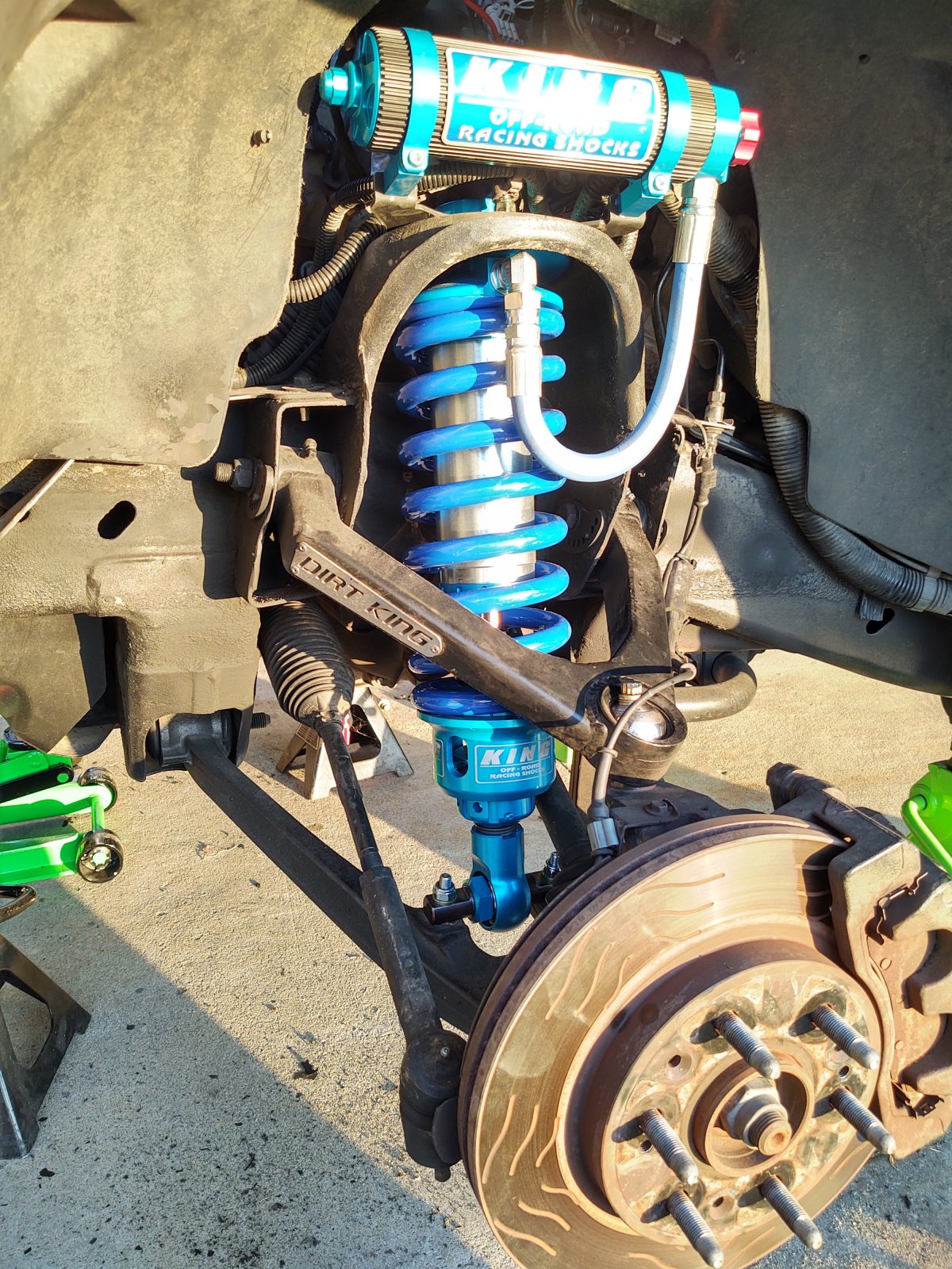

Adjustable 3" Kings coil overs in front, Dirt King UCA's
1" spacer in the rear, Adjustable King 2.5" Shocks and Cargomaxx 30-35% springs in the rear.

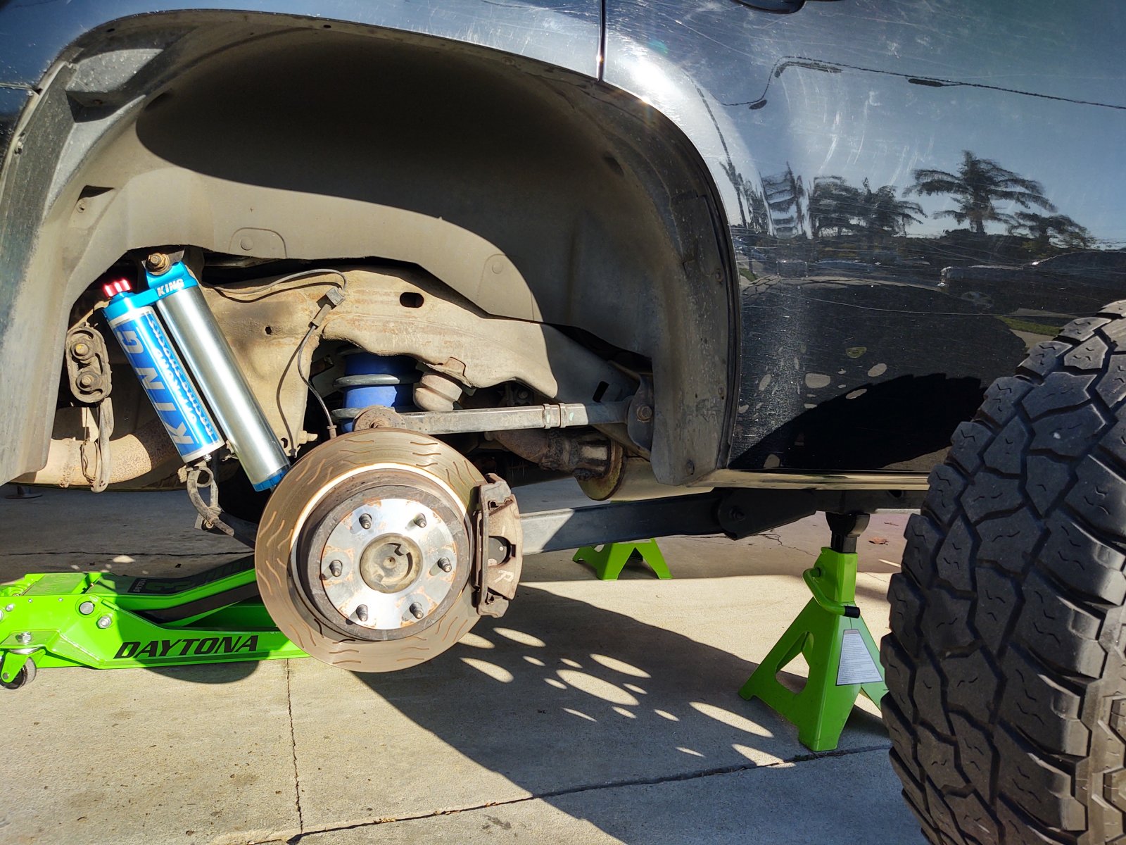

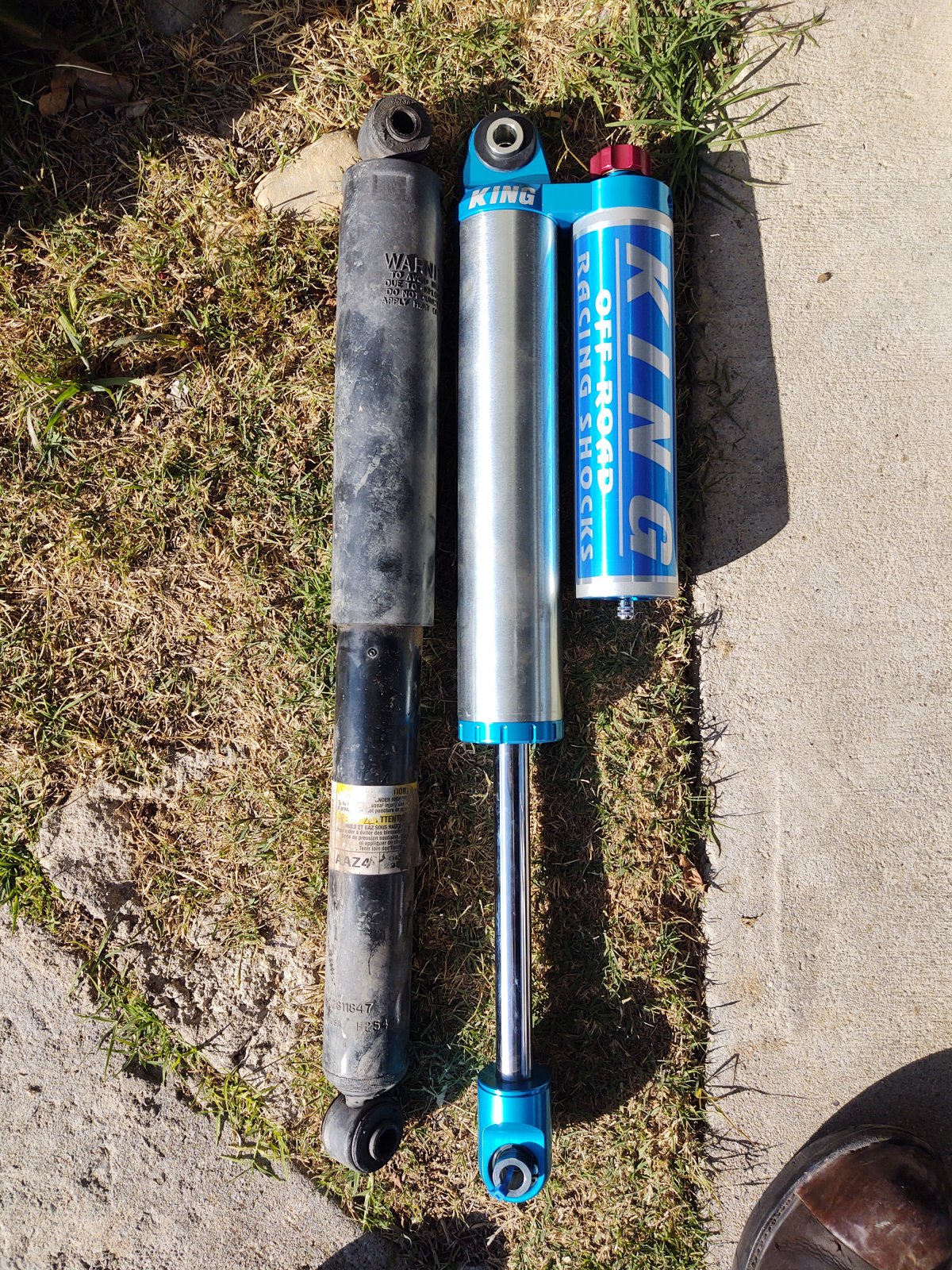

Rides great! A heck of a lot better than 130,000mi stock suspension.
For the most part I leave them in the softest setting.
Only have them off-road one time unfortunately though even with all the miles I put on them.
Also, the only reason I put a 1 inch lift spacer in the rear is because the Kings on the front and their lowest setting actually raise the front end 3in from stock.
I preferred it when I just had a 2 inch leveling kit in the front as far as ride height. And one thing I've noticed is that because the spring perch on the bottom of my King's is as low as it goes, the front axles actually have been rubbing into it for a long time.
So maybe someday I won't get shorter springs for the front so I can actually move the perch up and have some adjustability.
