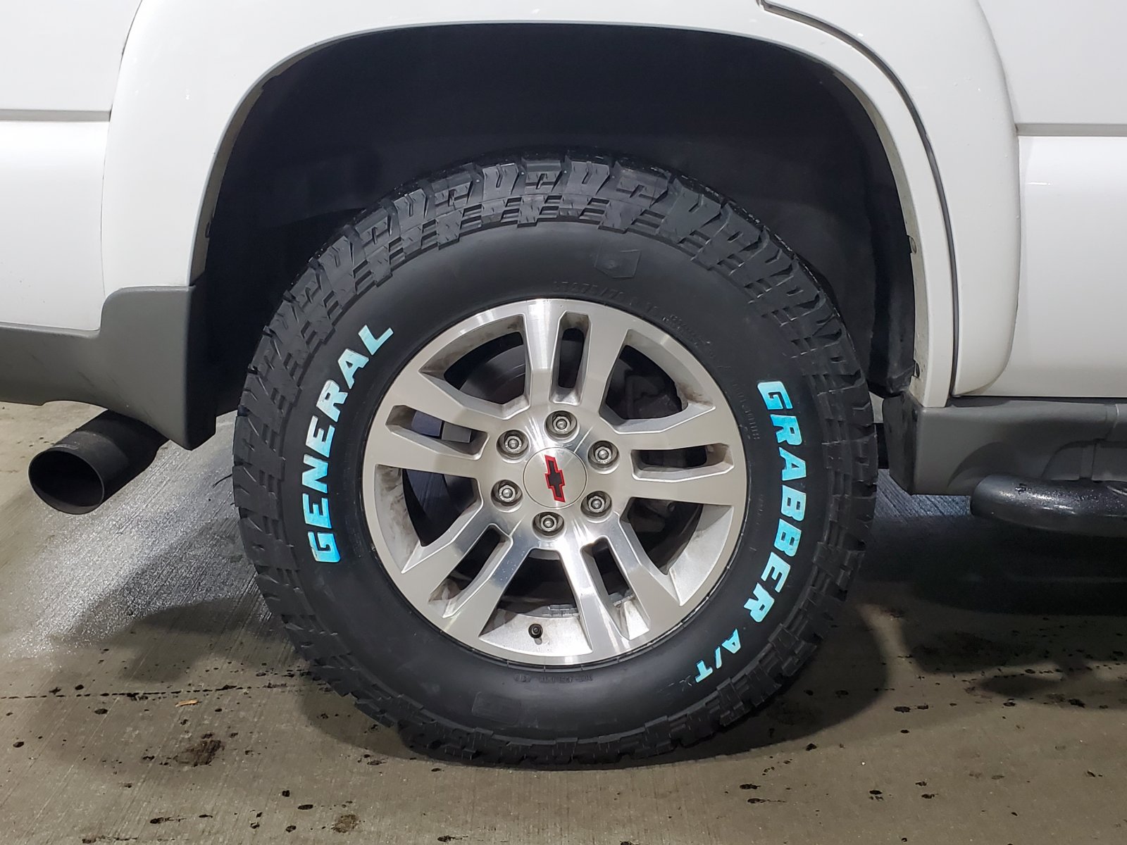

Well then. Thanks for your example! I had a reeeeaaaaalllly hard time finding setups that fit my bill for some reason. Yours pushed me over the edge. I put them on tonight.... they fit! Stock! No rub anywhere. It's close in front at full lock, but they clear.
This poses another problem...
I don't want to truck around a bunch on brand new tires without a fresh alignment. Already spoke to my hookup for that. Trouble is this...do I crank the front a little? I will give myself just a couple days to decide as I look at and drive it. I will get good measurements tomorrow. Doesn't look like it in the pics, but I think I just need a heavy inch in front to level. I Kroiled the bolts tonight in preparation....
My initial review of the Grabber ATX is a good one. They are super quiet and look awesome. I will post separately on them after a little time.
Pics for verification purposes:

Looking good! Yes looks like it needs just a bit of turn up front to level out.
