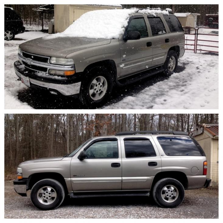

top before sorry about the pic angle like i said it was snowing when i started so it was hard plus i was as far as i could get away due to all the cars in the driveway that day.
fenders start : LR 35in RR 35.5in
LF 34.75in RF 35in
bottom is after my fenders are just above where most stock z's sit before i get tires so im ok with it now i guess
Fenders finish : LR 37.25in RR 37.75in
LF 35.75in RF 35.75in

thanks man i just wish she was alittle higher i feel like ive spent money now and not gotten what i wanted for it
