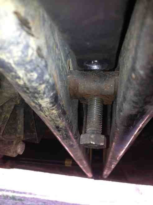

Alright measurements
Start: LH 34 3/4. RH 54 15/16
Rear: 35. 35 1/2
Final new tb, rcx z71 keys, z71 coils, bill 5100 all around
front left 361/4. Right. 36 1/4
Rear left 37 5/16. Right 37 3/4
Rear is left 2 5/16 inch higher
Right is 2 1/4 higher
Front Left 1 1/2 higher
Right 1 5/16
Measurements for rear with 1.5 spacer
Right rear 39 1/4
Left rear. 38 5/8
Wish I kept those but my tires would look dumb with that much gap but it was pretty
Claymationzoo
Claymationzoo
Aug 24, 2012
89
Maryland
This is how many threads are left like I said its barely turned up. And all my measurements are after it settled not jut went I dropped it off the stand
