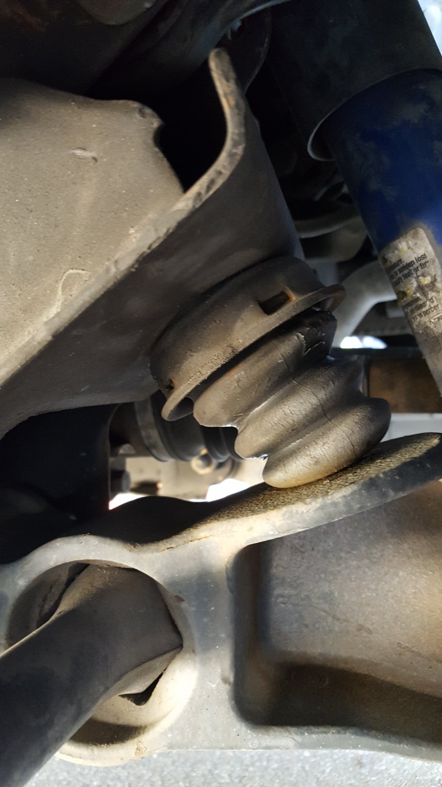

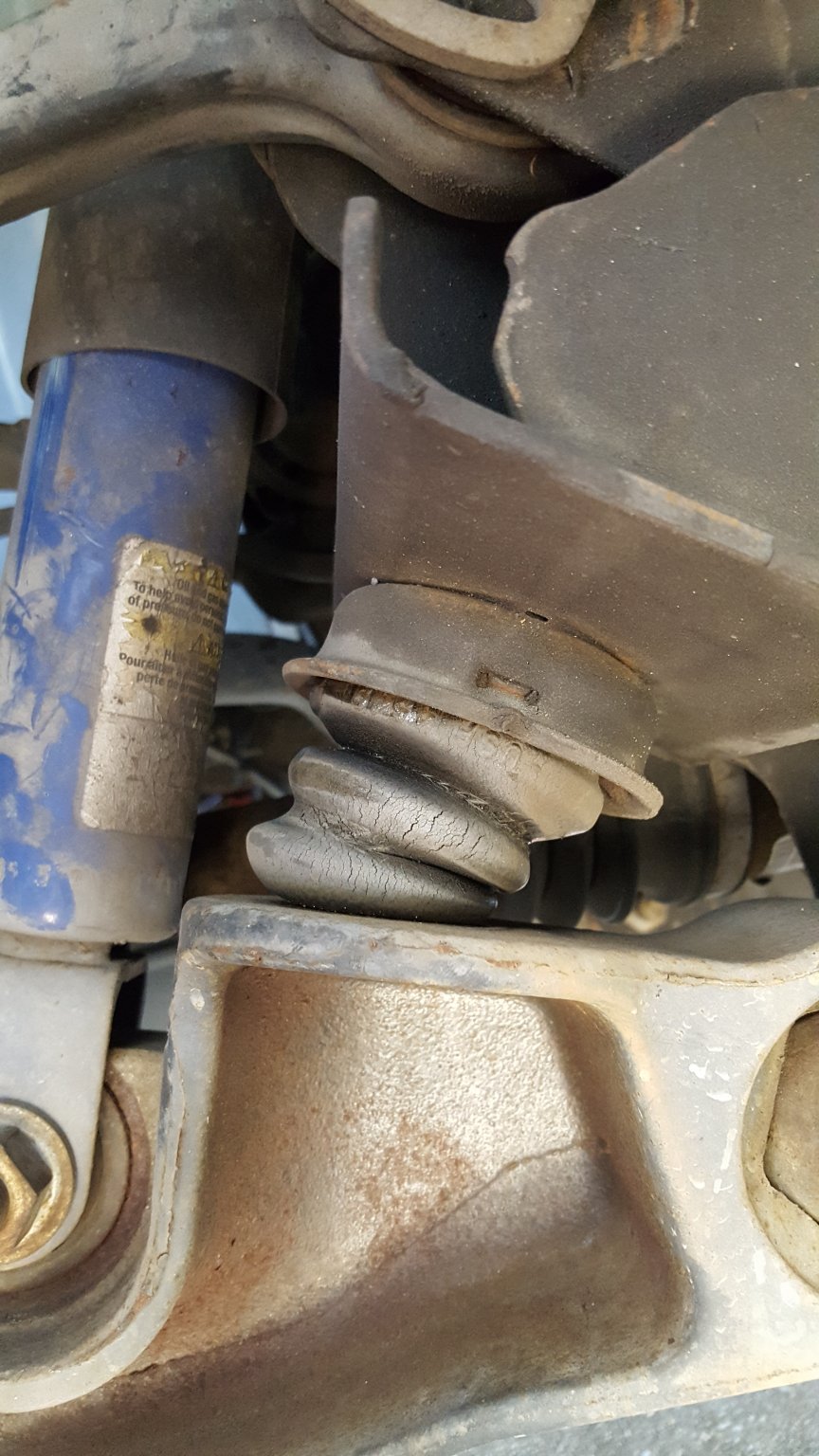

I can't believe I never noticed how the front leans 1" to the driver side, but now that's all I can see. Looking at my torsion bar key adjustment bolts, I've got about 1/2" to 3/4" left on both sides. Also, looking at posts about the front bump stops/jouncers, it's normal to have them touch the control arm. But mine seems excessive, like the front is riding excessively low, especially the driver side.
Passenger side:
Driver side:

So I guess my questions are:
1- Should I be able to get everything leveled out with my stock keys, or should I buy new ones?
2- In either case, should I upgrade my shocks to compensate for the front ride height difference (Bilstein 5100, etc.)?
3- If I do need the upgraded shocks, do I need to get new rear shocks to match the front?
4- Would the 1" front height differences explain the 1/2" difference in the rear height, or do I have something else going on?
5- I probably will replace the stock jouncers, as the drivers side looks pretty worn out. I think the part number is 15153958. Can anyone confirm? I've also read something about Z71 jouncers as a better replacement. Anyone have any info on this?
Lots of question, I know. But I'm pretty new to suspension upgrades. Thanks for any help.
