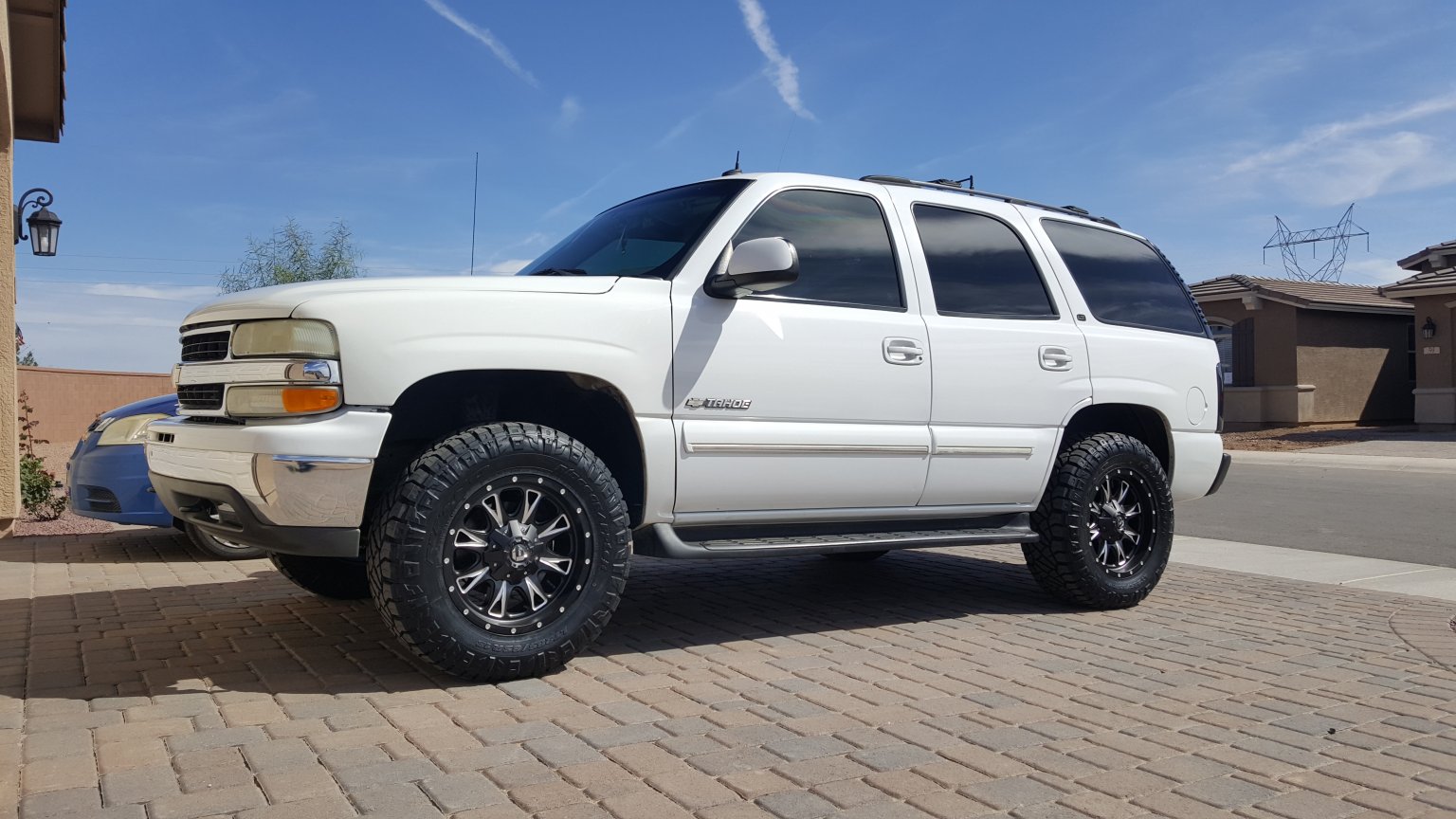

Leveled it
Dieselman84
Oct 10, 2016
Please let me know what you think. Pro comp 2.5 nitro kit,bilstein 5100 shocks, 285/65/18 nitto Ridge
Grappler, fuel throttle wheels.

Looks good, brother.
Tell us exactly how you did it.

I did the pro comp nitro kit 2.5 with bilstein 5100 series shocks.

My wife works at a lift shop so I got a good hook up and since I didn't have time to do it I just had her shop do it.

Any coil spacers on the rear? And there's finally another white one for me to compare to and get ideas! The tire and wheel combo is sharp! Still not sure if I want to go with 18's or 20's.

Yes it has a 1 inch spacer in the rear. The wheels are 18x9 with a zero offset. They just stick out enough to make it look clean. I have no tire rub at all.
