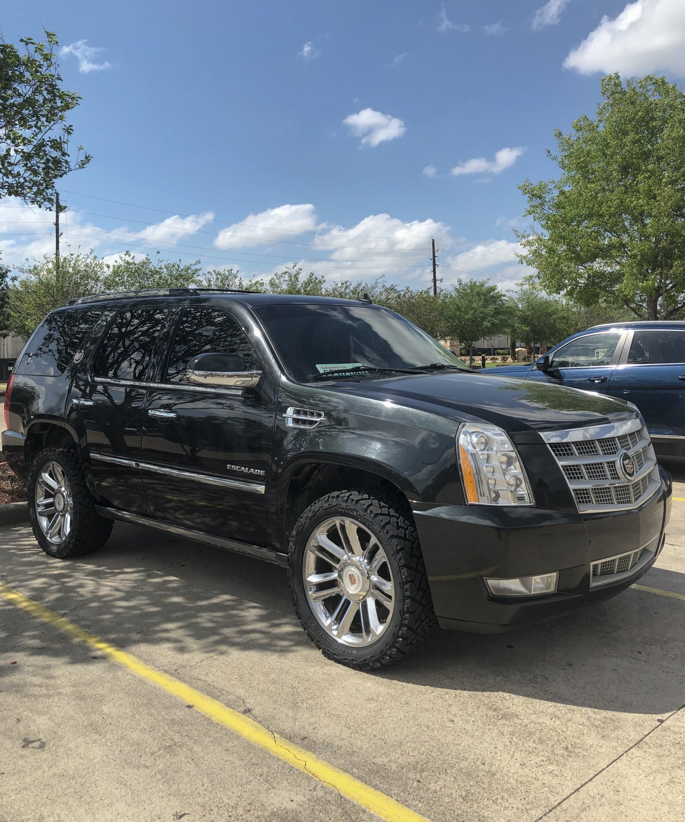

Hello folks,
I currently lifted my Escalade with the bottom strut spacer 2.5 inches. I’m having a problem on the UCA hitting the droop stop over any little bump. How are you guys getting around this?
At this point I’m considering just removing the leveling kit

I think I replied to you on another website but most people just cut that droop stop off. If you don't want to do that removing the leveling kit is another option

FWIW 5100’s don’t over extend as much as a strut spacer does. IMO they are the best option for leveling.

I’ve always cut the stops first thing I’ve never had any issues and I’ve stretched mine out to 3.5-4” before before I got my lift kit.
