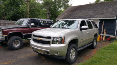

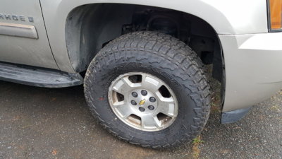

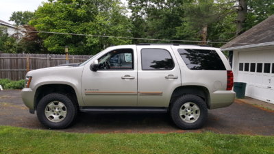

Another update for those who might be interested. Finally got new tires. I'll have to wait for new wheels as I had to divert that money to more pressing needs elsewhere.
The tires are Falken Wild Peaks AT3 P285/70R17. They ride great and I think look great too. Even the guy at the tire store was surprised that my Tahoe rode so well. I think the Bilstein 5100 shocks have more to do with that.
Anyhow I went with P Metric instead of the LT. After much debate I felt the P got better rain and snow traction ratings and they were a bit cheaper as well $184.99 a tire. Plus got a $70 mail in rebate for the tires too. The Tahoe won't see much off-roading except for maybe some trails and I don't tow anything so they should be just fine.
Can't wait to get new wheels. Might be a few months or more but I;ll get them.
