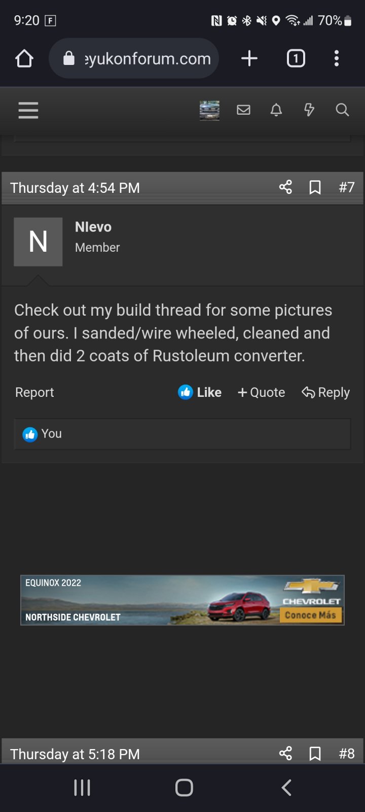

Check out my build thread for some pictures of ours. I sanded/wire wheeled, cleaned and then did 2 coats of Rustoleum converter.
Where is this?
That's exactly what I wanted to do. I have two friends with paint shops and wanted to lift the whole thing up and clean off all I could and the use the converter on it before I seal it. Then do the body work. I'm more interested in stopping it right now.

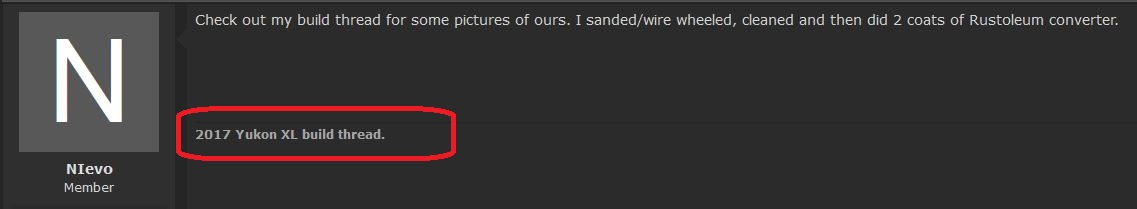

Where is this?
Click on the link that's in his last message:

Where is this?
Sorry, as mentioned its a link in my sig.
