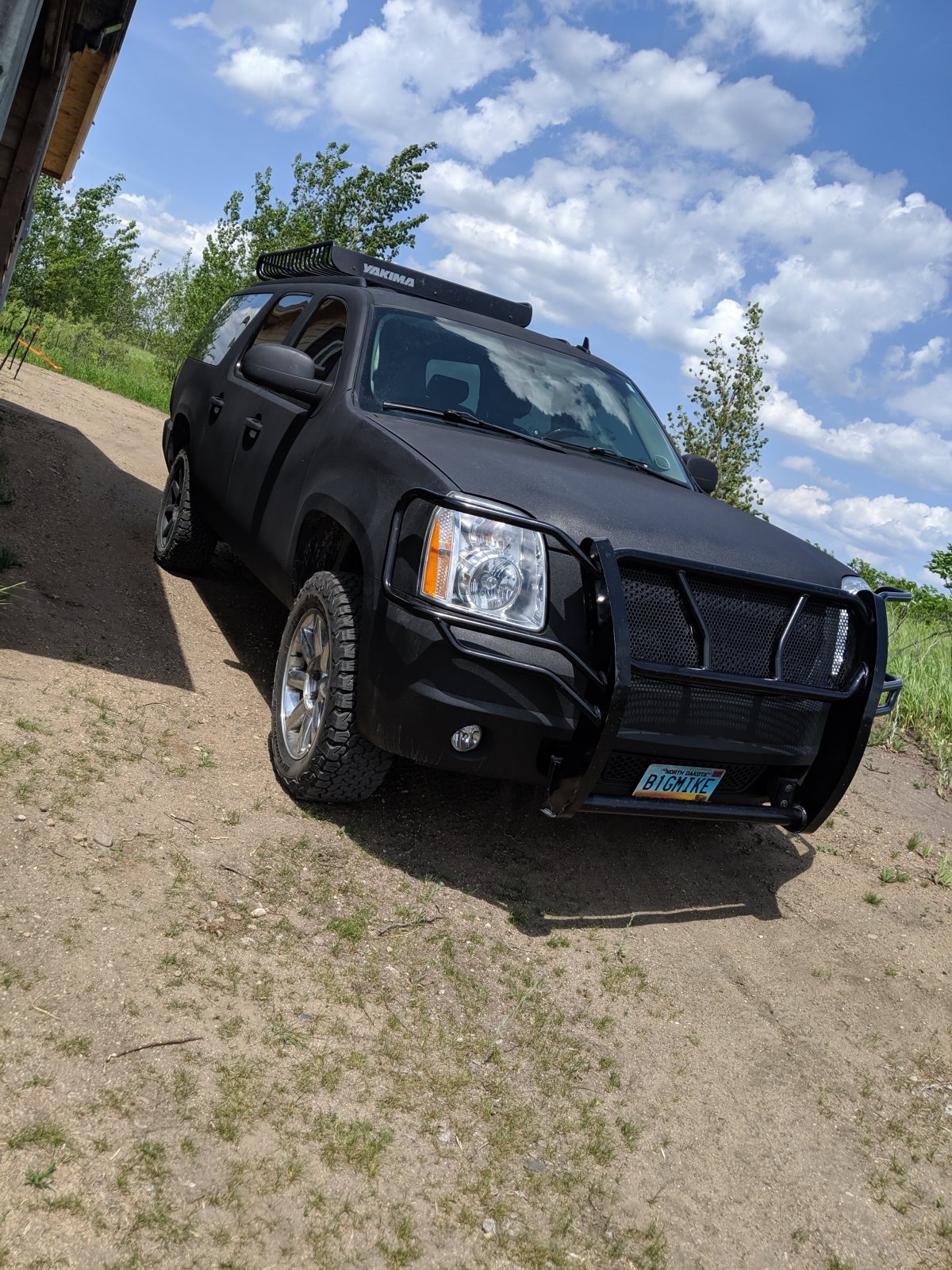

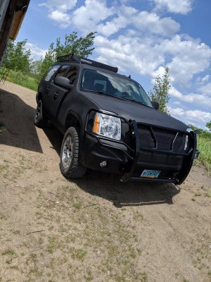

5100 Struts at 2nd notch, rear Z71 Springs/bags with 1in longer Bilstein's.

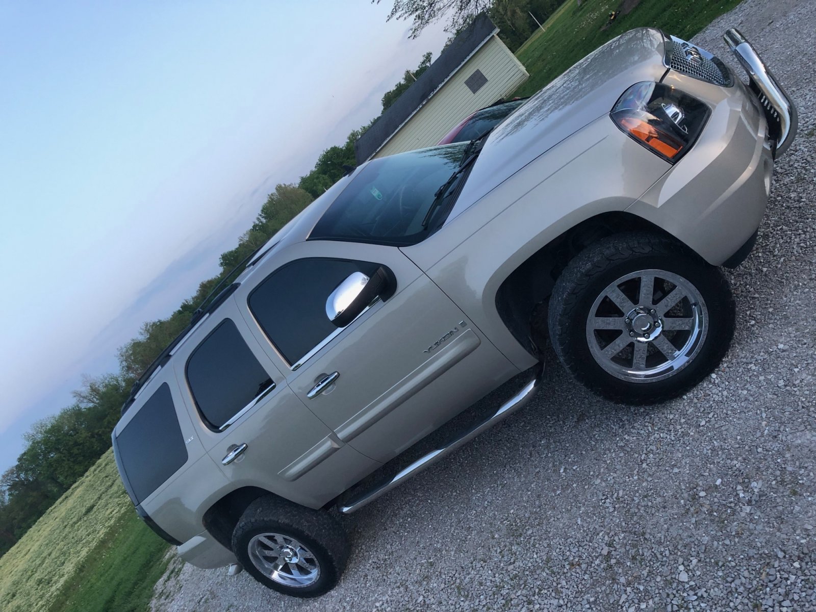

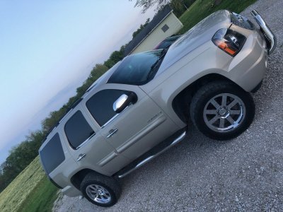

I just picked up a 2010 LT 4x4 after my 2003 Yukon got totaled out. This will be the 7th tahoe/yukon in the family (1999 to 2018). This one has a level kit, but not sure what size. Looks like a 2.5" front and a 1" rear. came with 28x10" rims on 295x25x28 tires, so i just replaced them with 20x9" Vision rims with a +10 offset and a set of 275x65x20 goodyear tires from Discount Tire. minor rub from the 28's caused inner finder wear so now i know where to trim for the new wheels. Slight rubbing with the new setup but i plan on trimming up the front fender wells anyway. I'll change out to a real lift and bigger tires once these wear out in a few years.
20190407_191159.jpg View attachment 223569 [ 20190520_175202.jpg 20190520_175219.jpg View attachment 223570 20190520_191615.jpg

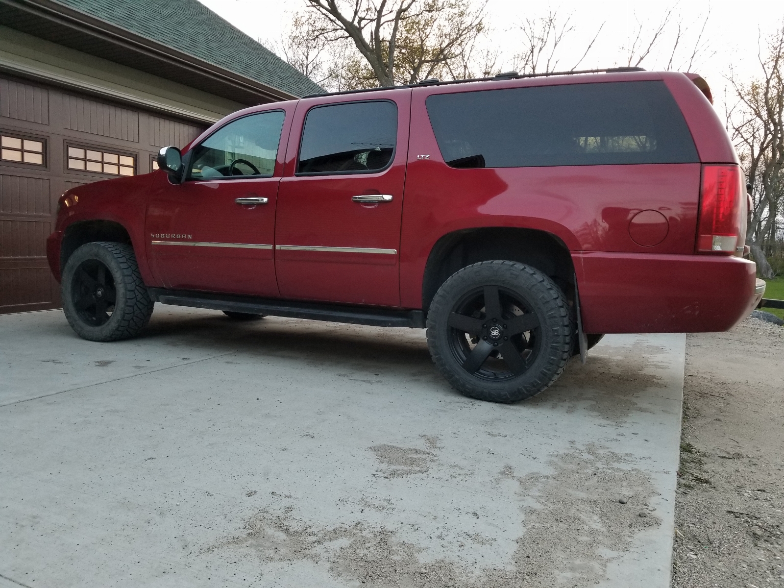

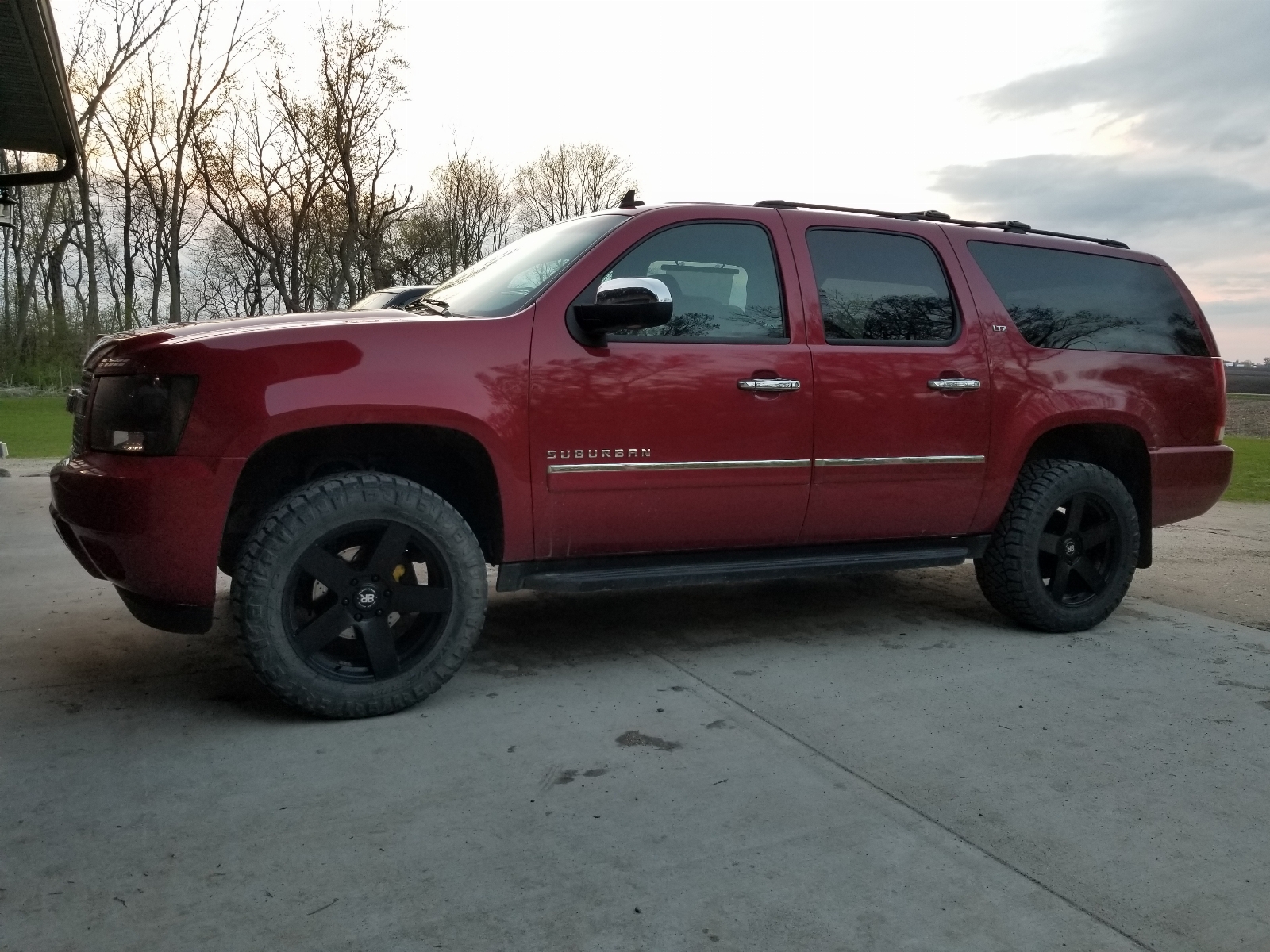

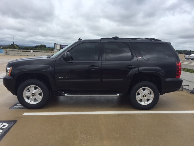

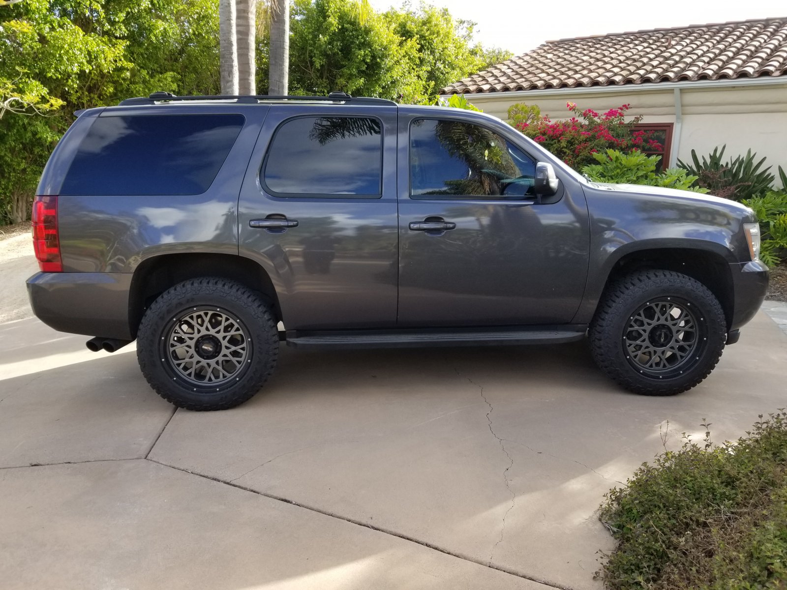

Just a leveling kit (3" in front and 2" in rear)
Wheels are 20x9 Moto Metal 962's with custom center caps (-24 offset) (One pic has the old ugly Moto Metal Caps in it)
Currently has the BFG 275/60r20 KO2s that came with wheels, but I have a new set of 285/60r20 Nitto Ridge Grapplers that looked awesome with my other wheels that I had on there briefly.
There are also 1.5" wheels spacers in the front and 2" wheels spacers in back to give beefy stance and even up the track width.
Took quite a bit of trimming to get minimal rubbing out of those 285 Nittos when I had them on there.

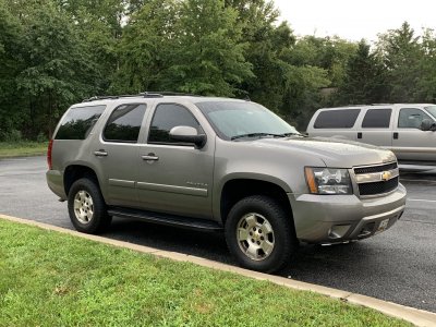

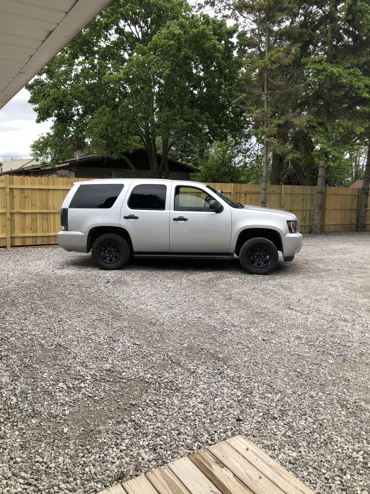

Finally got my CCM kit on yesterday. It's been raining basically ever since, so I was only able to snap a couple of pictures. After a lot of back and forth, I settled on Terra Grappler G2s in a 265/70/18. The weight is virtually identical to the stock tires, I haven't trimmed anything, and so far there has not been any rubbing.
Before:
After:
Your truck looks great! My Tahoe looks identical to yours and I've Just ordered a 2" leveling kit, with 275/65R 18" Toyo Open Country AT II, tires. Tires are slightly larger with a more aggressive tread design. Enjoy the ride!
