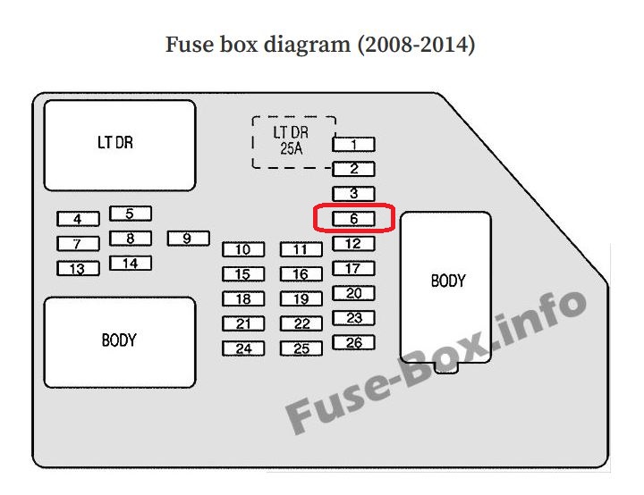

In the inside cabin fusebox, have the appropriate fuses been checked? Especially #6?

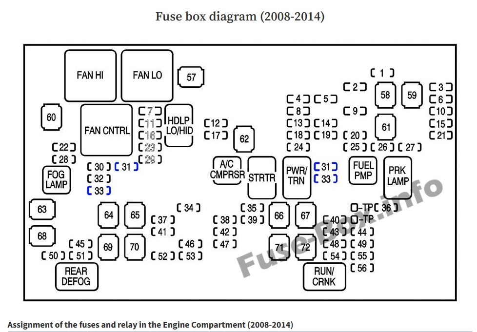

For the trailer lights, check fuses 25, 26, and 27 in the underhood fusebox. You may need to check others, so get your fusebox diagram and the list of fuse descriptions.
I'll check these now, I know I checked the fuses under the hood, didn't think about the cabin fuses.
All fuses are okay but I am missing number 58 under the hood, not sure if it's needed or not.

Might be fuse #5 inside the cab; don't just look at the fuse, measure the voltage on both sides of it. You can use the test points to measure the voltage on the minifuses without pulling them, but it's probably better to also pull them and check for pin fitment.
