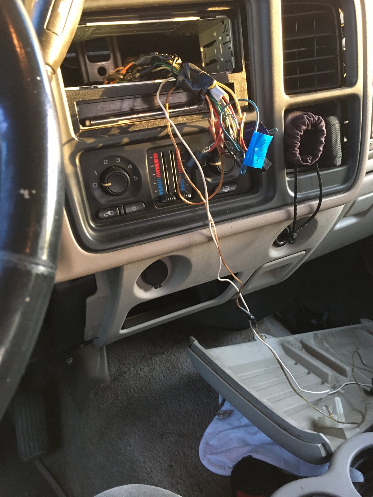

i cleaned up the grounds on the frame rail under the door. then i pulled the radio out along with the cluster F*ck of wires & electrical tape from previous owners half-a$$ed idea of an install.
so i will be rolling clean tmw morning & see where i’m at

my hope is that there was some interference or a bad ground but nothing is ever that simple in my world :emotions122:

Joe, that is a nice lookin' set of cluster f*** wires you got there in that dash. Those are purdy!
