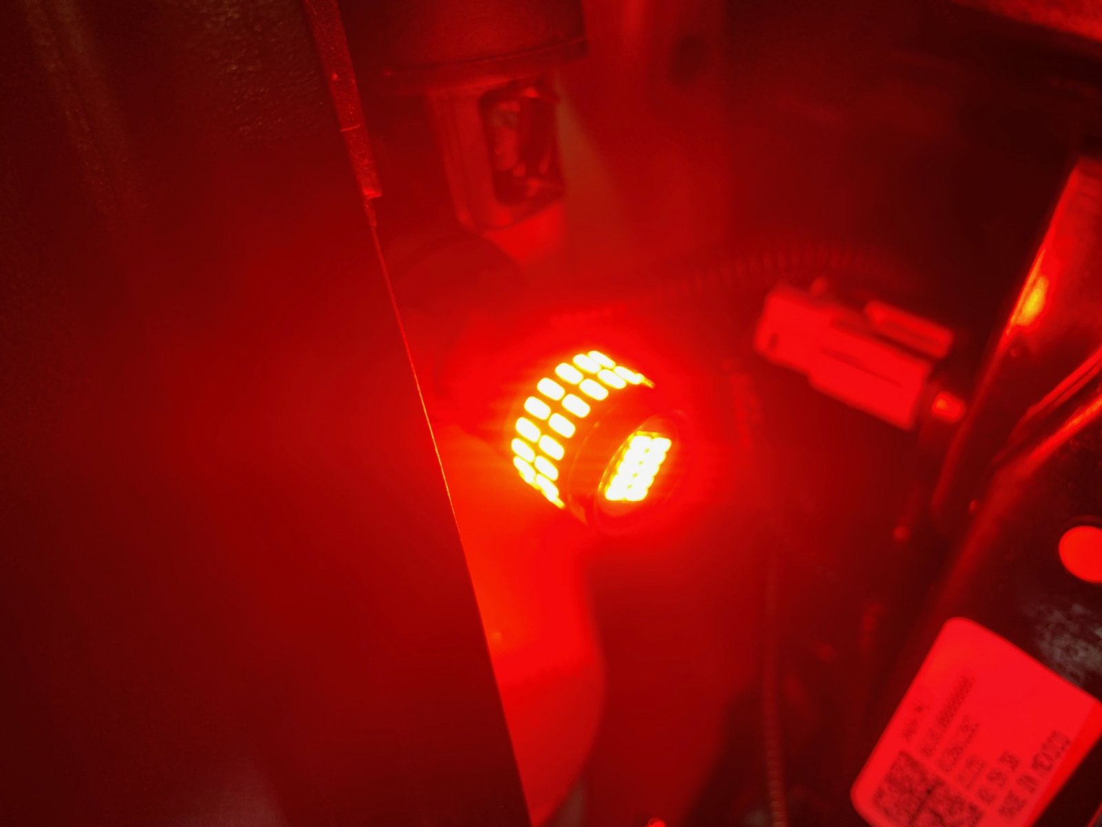

For the red brake light and white reverse I used the VLED 7440 red and white 921, the 921's are $ 80 for the pair and available in 5000k and 6000k. I ordered the 5000k.

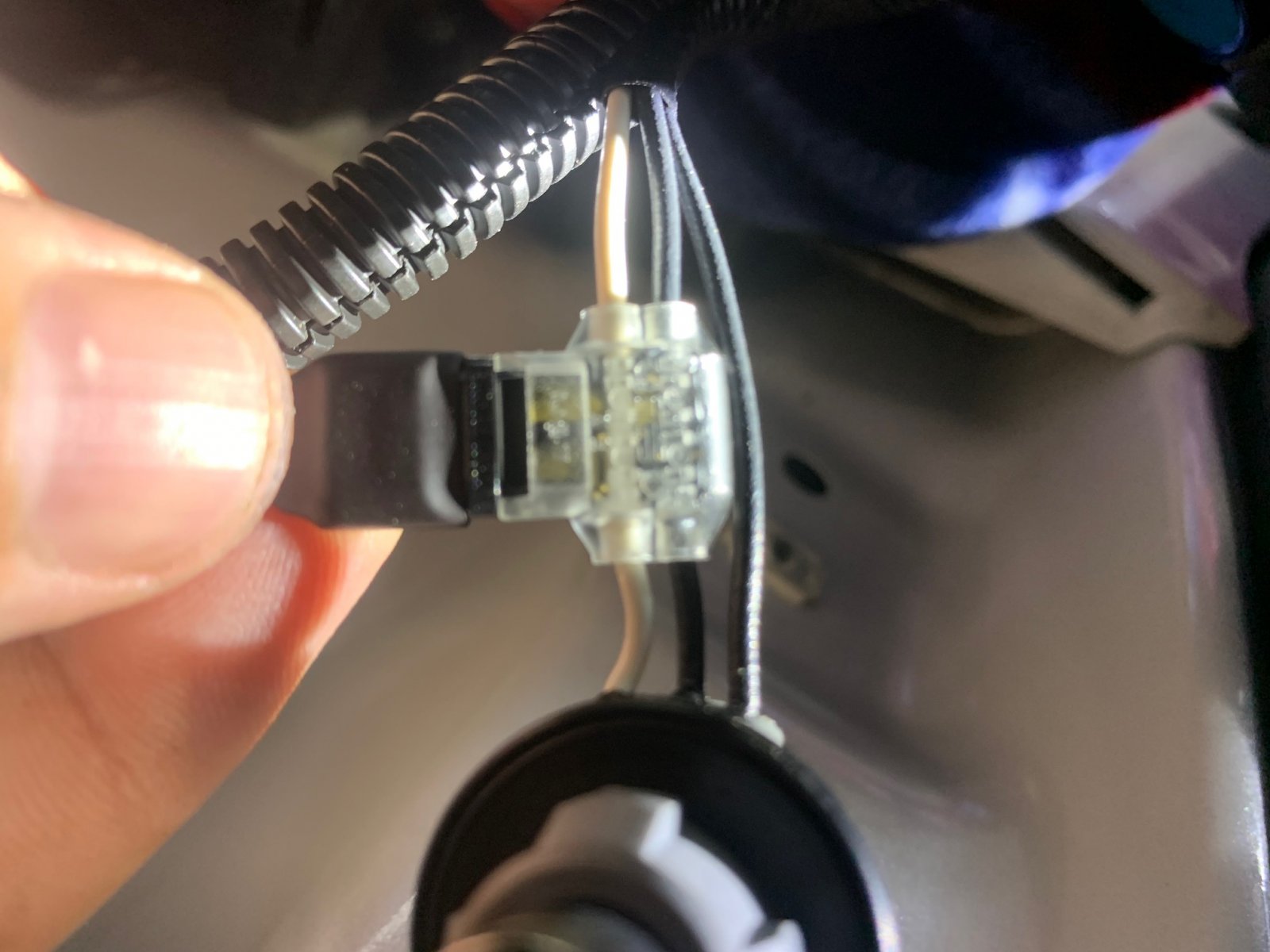

The duo tap resister harness allows you to snap the harness over the wires without needed to cut or splice the light harness. You do need so pliers to snap them together over the wires.
Also the tap is for two wires and the factory harness uses three, you have to do some trial and error to see which two wires are the correct two. I did one bulb at a time. When I installed the bulb I turned on the Tahoe to make sure it worked, and then the warning would come on the dash for a bulb out. Then I would install the resistor to that bulb and recheck that the warning was gone.

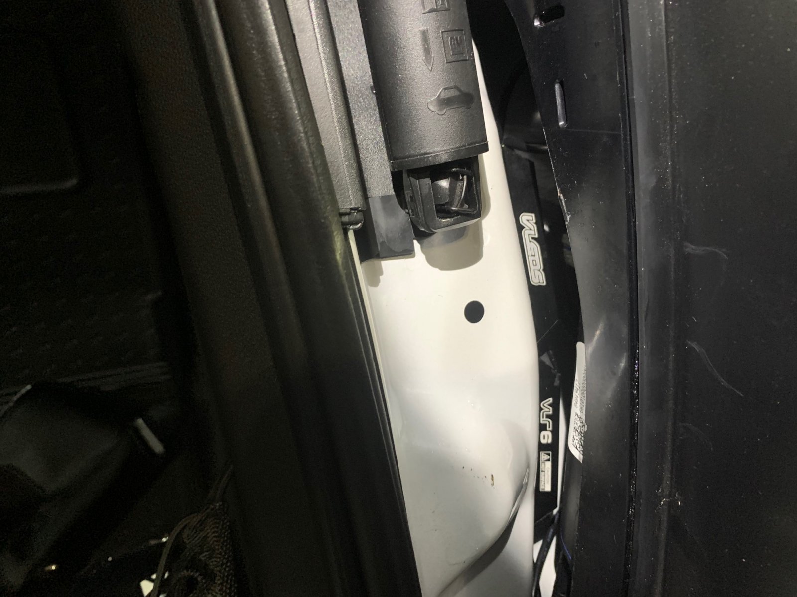

Here you can see the resistors mounted behind the tail lights, plenty of room and their not touching the taillights so they should have plenty of space to get air so they don't over heat.
