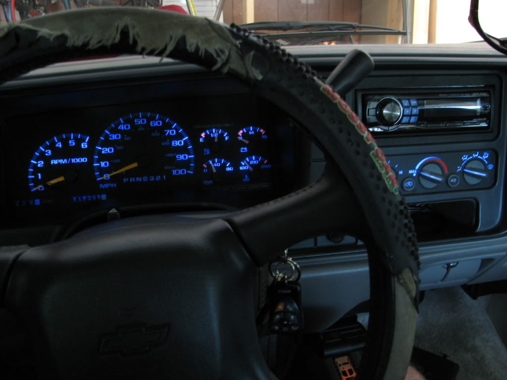

i put in my blue leds in the dash this week end. let me know what yall think

whered ya get your LEDS and what it cost ya?
blueflamed, its basically pulling out the old bulbs from the sockets and sticking in the new ones..
scz71864
scz71864
Aug 30, 2009
62
its really easy, and as far as the year goes it should all be the same. and yea its as easy as pulling the dash off and the cluster and twisting the old bulbs out and putting the new ones in. i got them from superbrightleds.com for around 30 bucks to do all of it

I like it looks good. I just wish i could get led's that don't go out quick.
scz71864
scz71864
Aug 30, 2009
62
the ones i got are supposed to last for 55,000 hours

I'm about to do mine as soon as my LEDs and new cluster come in. Can't wait!
TahoeGoBoom
blue interior guy
May 1, 2009
720
iirc, nbs from 00-02 are soldered. 03+ are an easy swap.
so u should be good blueflamed03.
Its nice to have some color, isnt it? lol

I think it will liven up the interior, but looking at Nu Image gauges bezel too first, so can do all at once.
