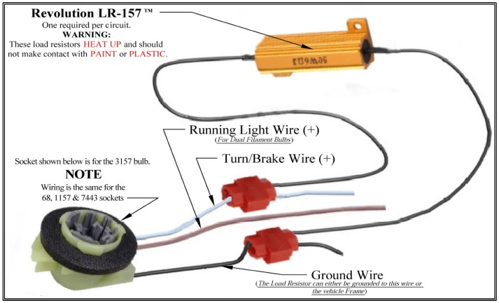

To correct the turn signal hyper flash you'll need to wire in resistors on each rear bulb.
