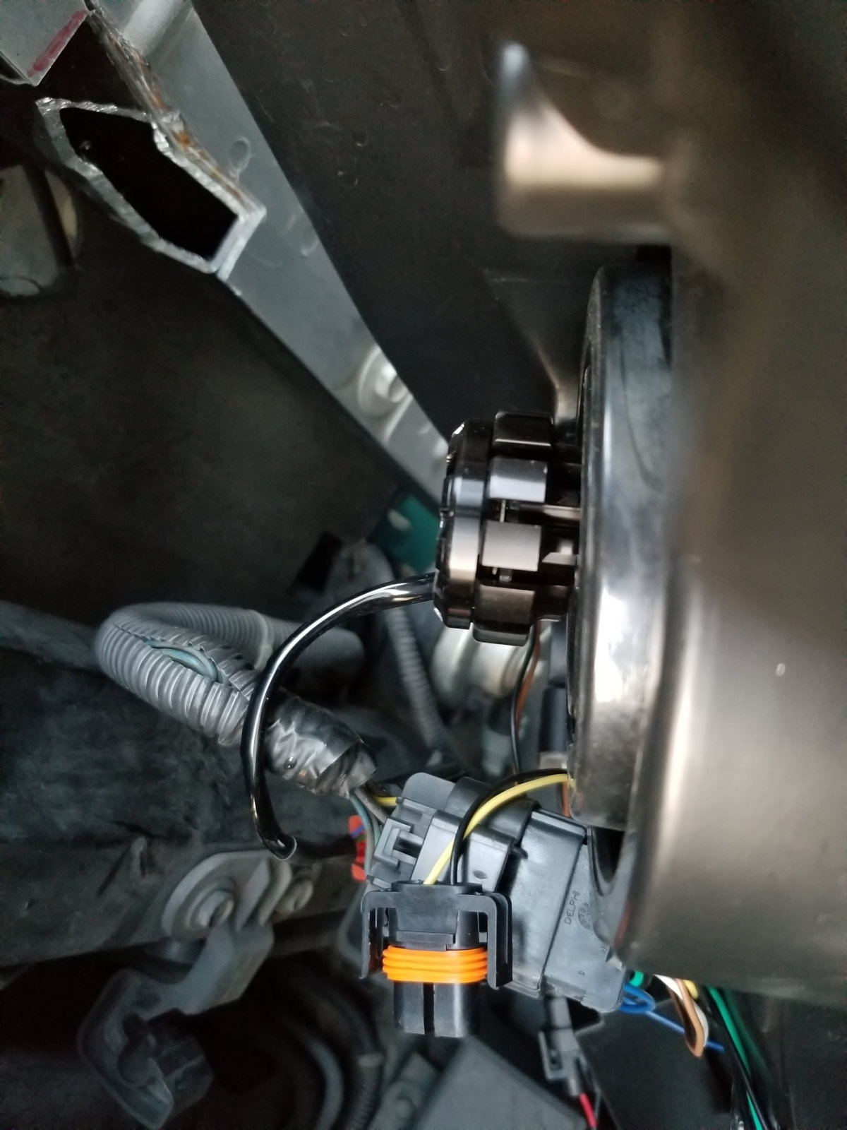

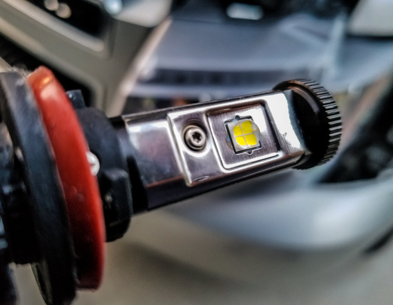

Here are the LED bulbs I went with - You'll find LED's range from about $40 to well over $100 for a pair. I was happy with the feedback on these, and ended up buying the anti-flicker harnesses with them also. You can fit these in your housings with no modification! You don't need to trim the core supports like you would with other brands. Speaking of, I actually have clearanced my core supports already for the bi-Xenon, as it was necessary with how far the projectors protruded out of the back. I can clearly see behind the headlights though, and there is plenty of clearance with no modifications needed.
You do the math, I am in new headlights with LED low beams installed for about $200. Win win win.

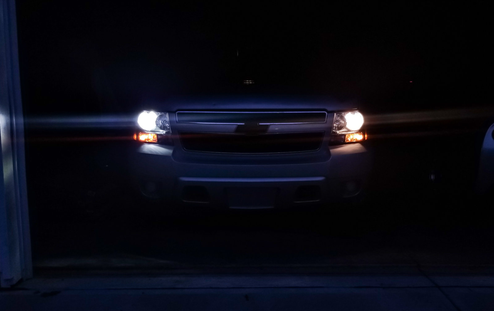

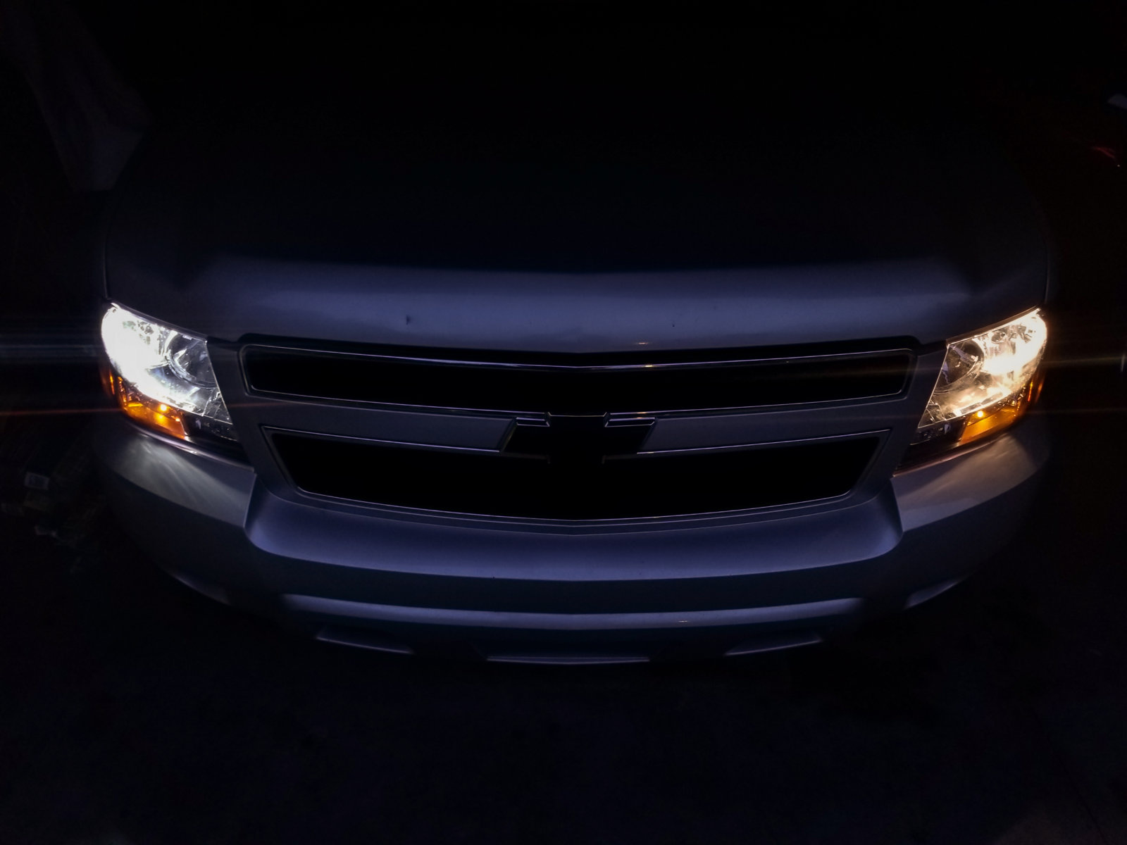

Pics are attached. If anyone would like to see anything specifically, let me know.
20180830_234150.jpg 20180830_234215.jpg 20180902_182007.jpg 20180902_182128.jpg

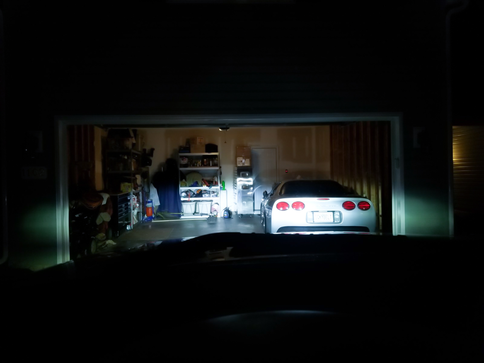

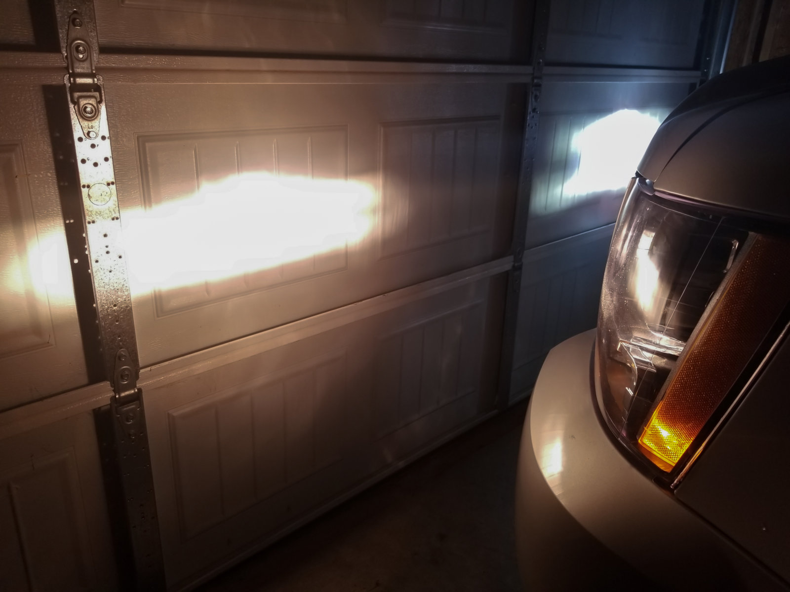

You wouldn't happen to have any pics of the halogens up against your garage?

Yea a side by side I think might sell it, at least for me.
44,972
Change one side back to stock (whichever's easiest) and snap some pics. I like the "one side stock, one side LED" comparisons in addition to the full "before" and "after" pics.

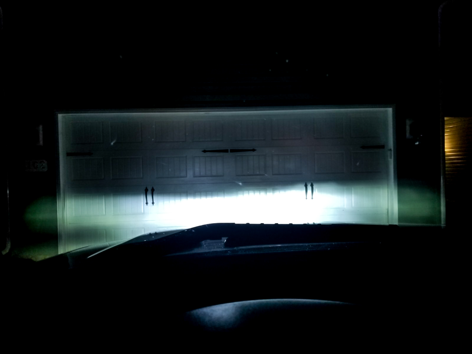

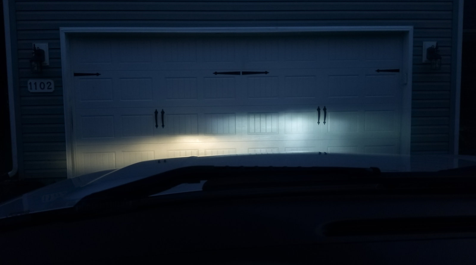

I'll try to toss in a halogen tonight after I mow the grass, then I'll get a garage pic and pull it out in the driveway to get a comparison shining on/in the garage.

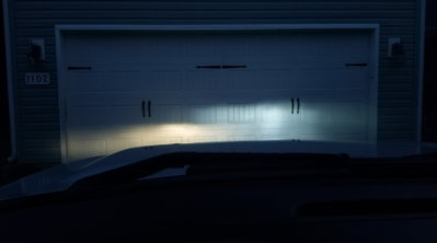

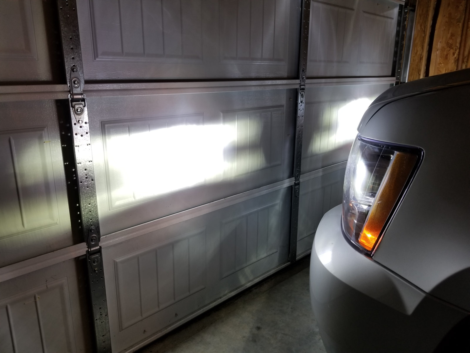

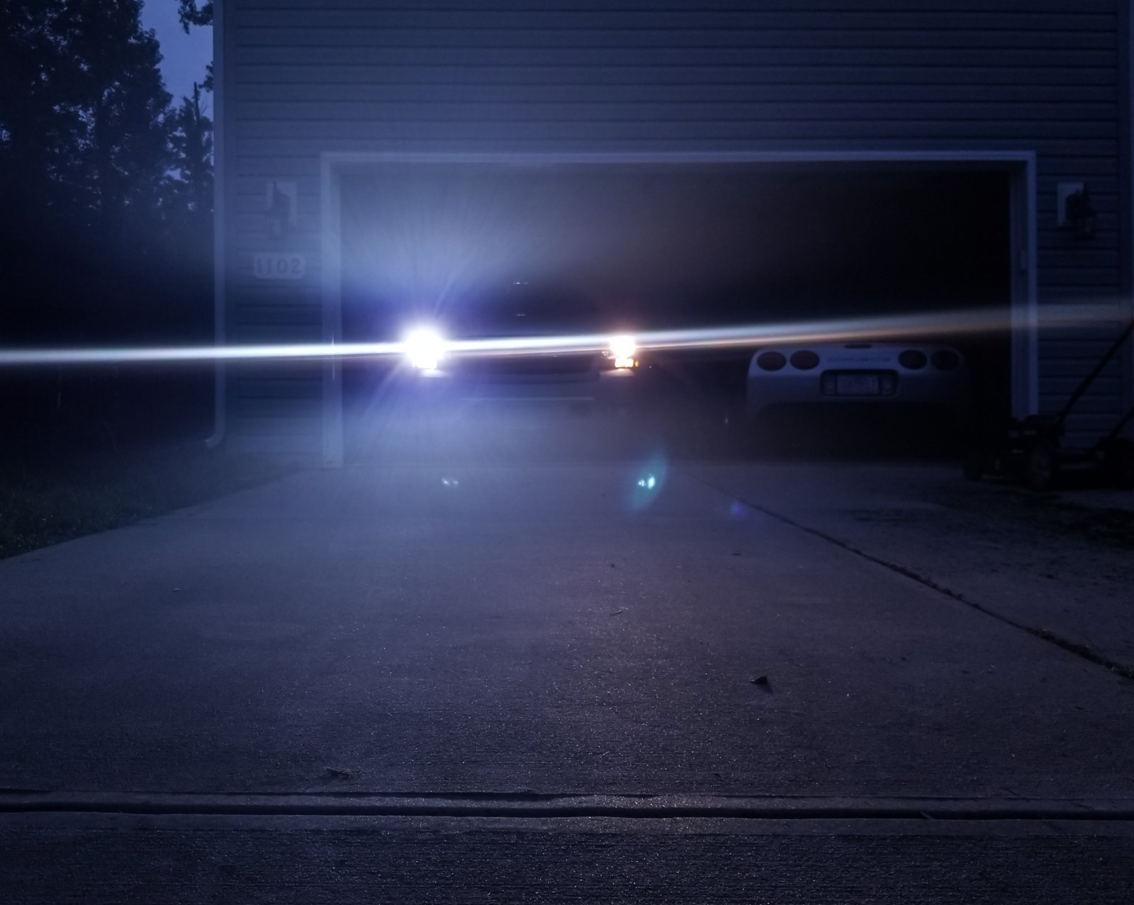

Pics coming, got the drivers side swapped back to a normal H11 halogen bulb. If this doesn't convince anyone enough I don't know what will. This is about 25 feet out, the camera/phone is about 3 feet off the ground. Ideal level for adjustment, so you aren't blowing out the passenger car's mirrors in front of you at a stoplight. You can't even tell the halogen is doing anything, the LED is so bright.

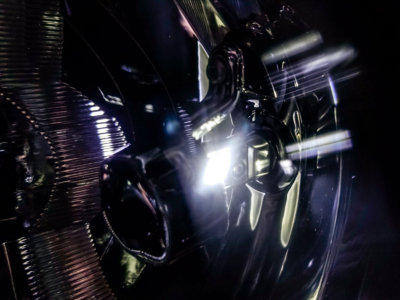

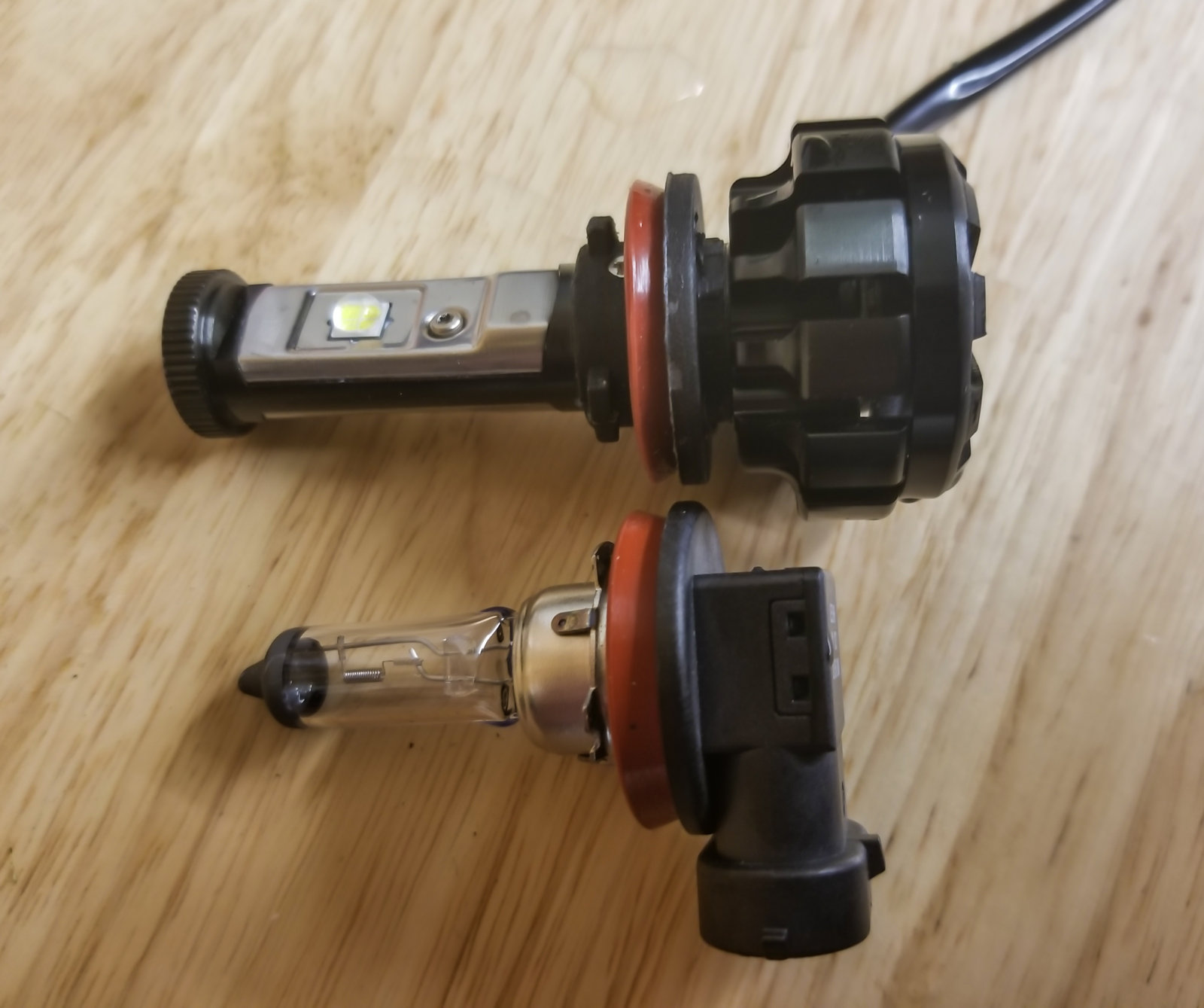

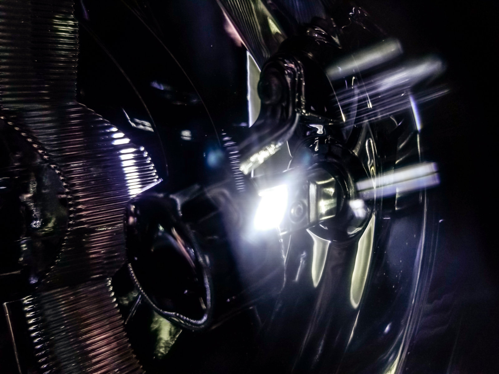

Some of the headlight and the LED's, comparison to show the mounting depth. In the picture of the LED installed with just the back end showing, you'll notice my core support that is clearanced for the former bi-xenon Morimoto projectors.
20180904_193550.jpg 20180904_193541.jpg 20180904_193631.jpg 20180904_195255.jpg
