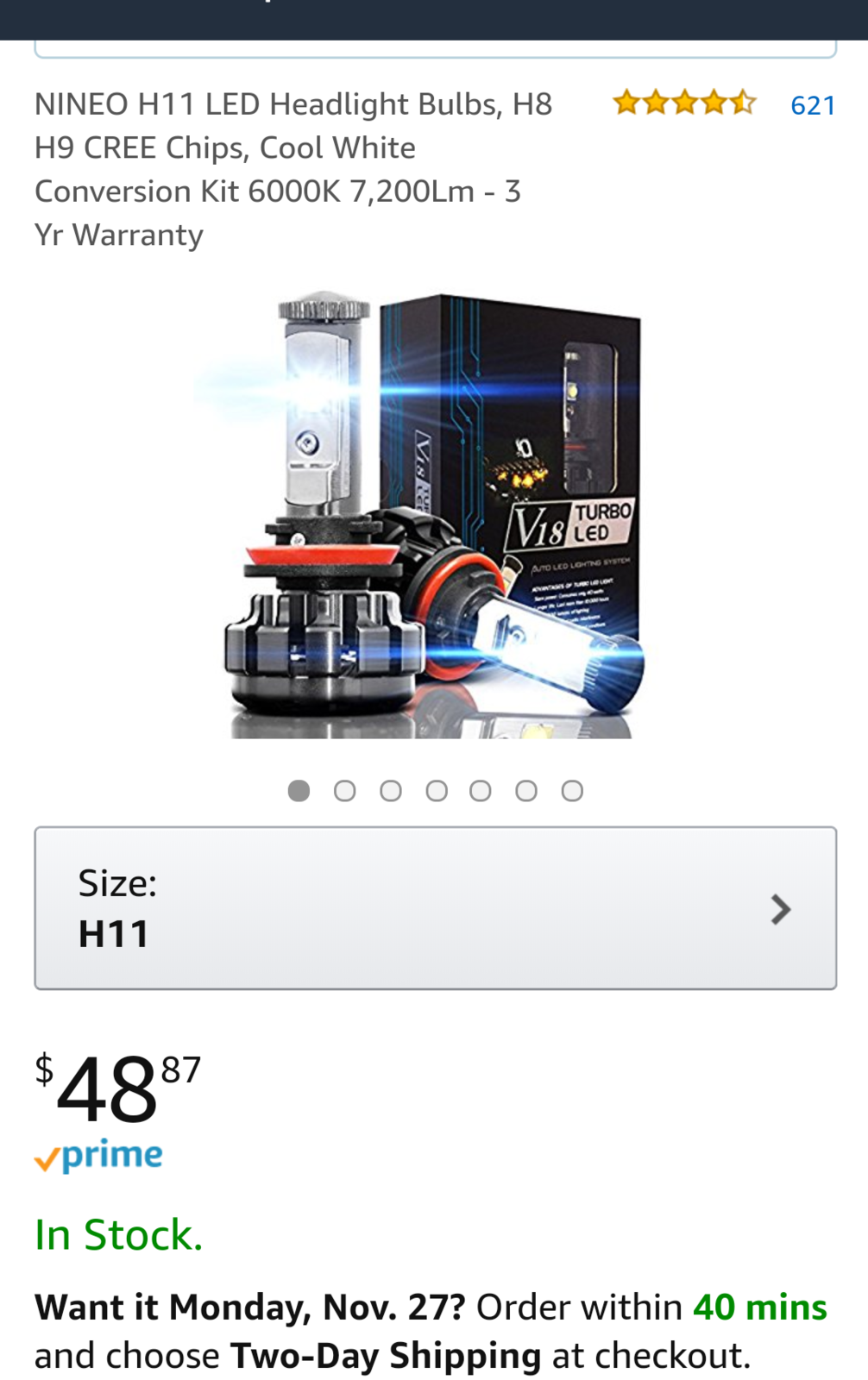

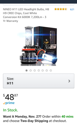

Ive had leds in my 10 tahoe since april that were suggested by another memeber here thats been running them for awhile. So i took a shot. I live in the country where we dont have street lights and lots of animals crossing the road, these lights work great and light up a good covered area in front of me(not spotty). On the blinding other drivers i have only had a couple flash me and its always been raining out. After a minor tweek i havent had anymore flashes (im also lifted)
Edit: oops i forgot the op had a denali. These specific leds are just low beams lol but the company has been gtg
