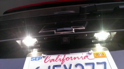

Still not totally dark, but you get the idea:

Much much better
Its funny how just little things like that improve looks as well as functionality

Two things.....
1) Gotta watch out on length.
Those look a lot longer than the stock bulb and you may not be able to fit them.
2) I tried directional LEDs for my plate lights and, since the fixtures are vertical, and off to the side of the plate, the illumination was very uneven and didn't look right. I ended up switching back to the 5 LED units and the distribution was much better.

The 5 LED type I have are the same length as a 168 and the light spread works well. The first super bright ones suggested and some of the others definitely do not work for both reasons.
