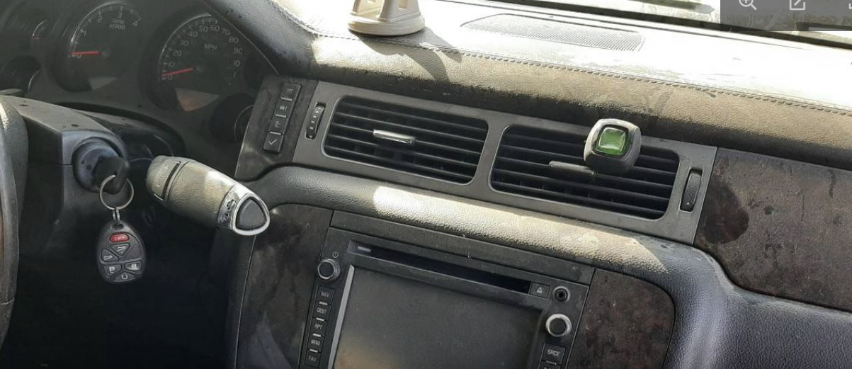

resurrecting again, saw pictures of one at a somewhat local wrecking yard
can't tell if it is a cap or not, but might be. it's a 2012 denali

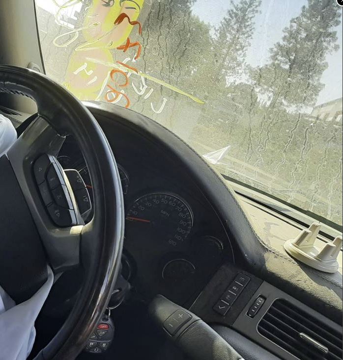

Bump for pic of actual leather covered Yukon dash with French seams living in the wild. Didn't GM stop using the speaker in the center of the dash in 2010?
